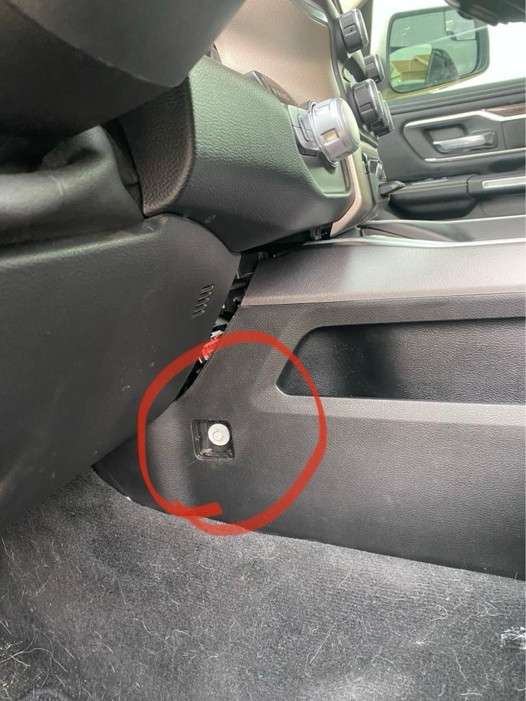

Hey all, I just swapped out my jump seat and installed the center console. Everything looks great! Does anyone know the part # for this though? My center console didn’t come with the pieces... I already ordered the other 2 trim pieces and should be here any day..
I believe this is the number I bought for mine.
5YM56LC5AA
