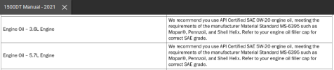

Dang it - I owe you a tall pour. I must've gotten one of those old 5.7 Hemis that clearly state 5w20 on the oil fill cap and repeated in the owner's manual. If I can get above 17 mpg average, I might consider an update to my oil preference. Otherwise, I'll stick with the silly owner's manual (page 475).
3.6L says 0w20 for the 2021 model year. I think oil grades are like presidential politics, pick one (red or blue), it doesn't change much.

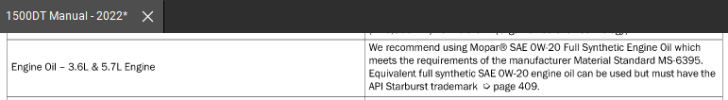

They dropped the shout out for Pennzoil and Shell, wonder what happened there?
HSKR R/T
locally hated
Jul 25, 2020
9,940
9,769
Contract with Pennzoil expired. Just like when they witches from Mobil1 in the SRT line to Pennzoil. Better deal somewhere else.

I’m sure this has already been covered but both of those are 20 weight oils. The only difference is that 0W flows a little better when it’s very very cold.
the operating temperature of the motor is much higher than the hottest day you’ll ever encounter so “hot” weather is irrelevant. It doesn’t matter if it’s 70 or 110 outside if your motor is operating at 210 degrees. This line of reasoning comes from decades of oil change upselling. The outside weather only matters for intake air temperature and irrelevant to oil.
dropping down to 0W from 5 give the oil a bit more cold range and allows Ram to consolidate all their oils into a single larger buy. 0W used to be a lot more expensive than 5W. That’s no longer true so purchasing smaller quantities of 2 different oils , one of which was cheaper probably doesn’t save FCA enough money to be worth the effort vs the savings of buying 1 oil in larger quantities so the recommendation changed.
Unless you live in Alaska or Northern Canada your motor is unlikely to notice the difference. Once the oil is at operating temperature both of those oils behave the same.
If you’re in the habit of allowing the motor to idle a bit when you start it until the RPMs drop before putting any load on it you’re even less likely to notice any difference.

The recommendation changed after the 2021 model year.
If you start looking back farther, 5W30 was in the manuals in the past. Then 5W20, then 0W20....with NO changes to the engine whatsoever, only changes to environmental law. Hmmm.....
So there's what works best for the consumer (5W30/5W40) and then there's what works best for the automaker (0W16/0W20). I'm a consumer, so....
That's not true. 5w-30 was recommended until they added MDS to the Rams. Then when MDS was introduced it switched to 5w-20. The Chargers/Challengers/300s always had MDS with the 5.7l, and 5w-20 was the factory recommended oil from the start of the LX cars.
