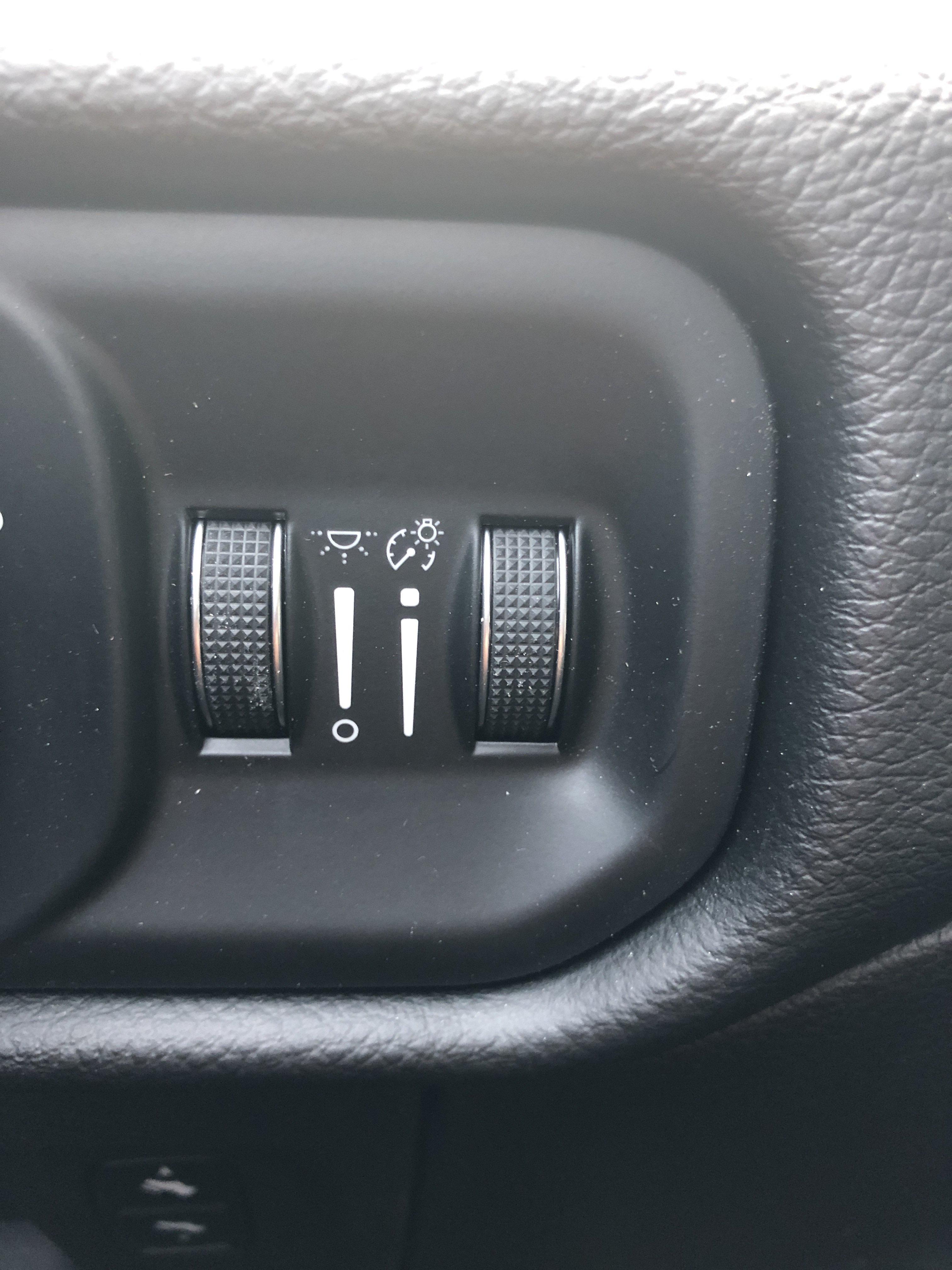

Can anybody confirm this dial works?

Thanking everyone for the information on this. I refused to believe that my 2018 1500 Laramie came with the ambient lighting and my 2019 Lamarie Sport did not. Here's what I confirmed...if the right rotary switch (instrument panel dimmer control) is rotated to the upper detent, the ambient lights will not illuminate. If the right rotary switch is rolled slightly down from the detent, then the ambient lights will illuminate. You will then have to rotate the left rotary switch (ambient light control) to your preference. The instrument cluster does darken when the right rotary switch is rolled from the detent. The Uconnect > Apps > Settings > Display will allow you to make adjustments when placed in manual mode but I believe this adjustment is just for the Uconnect display. You can adjust the brightness according to when the headlights are on or off. I will have to investigate further in total darkness as to the brightness of the instrument cluster by making these adjustments. I know the 12" system is quite bright at night and I will be tweaking my adjustments to my comfort. If I find anything else concerning the instrument panel I will respond.

I JUST picked up my NEW 2019 Limited TODAY! First thing I noticed was the instrument lighting issue - too bright when right rotary is all the way up, not bright enough when right rotary is "backed" off from full. Has anyone heard from their dealer or the company directly on this? Seems like this would be an easy fix - change the granularity of the rotary switch.

My understanding/experience is that when the right rheostat wheel is set to max bright (at top past the detent), then it sets the brightness of the instrument panel and the central display screen (the u connect navigation screen). The central screen has a separate display brightness setting in its menu. When it is set to automatic, then the right rheostat wheel controls the brightness of both the instrument panel and the central screen. When the menu setting on the central screen is set to manual, then it controls only the brightness of the central screen. You can turn your headlights on and pick a setting for the central display brightness between 1 and 10 for when your headlights are on. You can then turn your headlights off and pick a setting for the central display brightness between 1 and 10 for when your headlights are off. None of the central screen settings cure the problem of the abnormally dim instrument panel lights noted above. In addition, like the problem with the rheostat wheel, the central screen brightness adjustments seem (to me) to give abnormally dim central screen brightness. In manual adjustment the lower display numbers (say 1-5) are so dark as to be useless, just like the problem with the rheostat. You have to go up to a manual brightness setting of 10 to have anything that is even marginally useful. A central screen setting of automatic is no better.

There are some other threads in this forum about ambient lighting but yes if you have the right dial turned to the brightest setting it turns off the ambient lights even if you have the left dial on the brighest setting. Try turning right dial down one click from highest and pull in somewhere dark. You will see ambient lights on. This is how FCA designed this..unfortunately.

Information regarding the feature and operation of the ambient lighting control will be found on page 76 of the 2019 Ram 1500 Owner's Manual.

I get what you're talking about. It's either full on, or the notch down seems to be half and adjustable the rest of the way down. Does anyone have a wiring diagram for this subsystem? I had an idea that adding a resistor in parallel with the top portion of the control might raise the adjustment range. Or it might draw more current and overheat the control, in which case a slightly more complex power transistor follower might do the trick. One of many tiny improvement ideas I've had that may or may not see the light of day.
