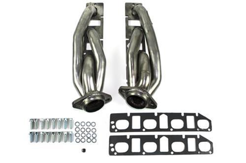

These trucks have been out a few years now, does any company make headers that are CA legal?
JBA is the only one I know of.

Looking at the EO order, while it may not be specific on there, it only goes to the 2017 model year, so I'm guessing only the Classic 1500, not the DT is what these apply to.
You’re right, I never actually looked at the actual order, just where Summit said it was CARB approved.

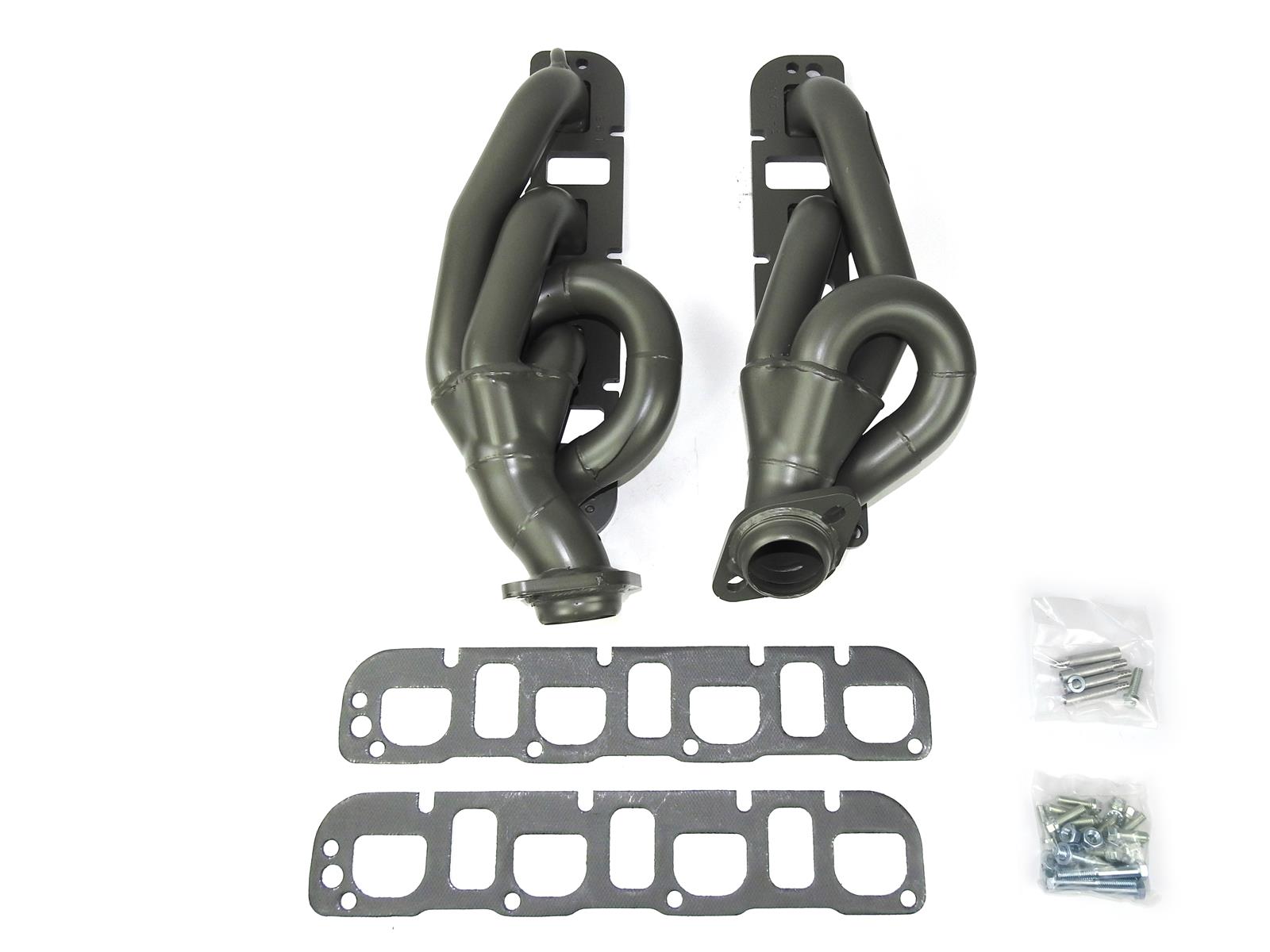

Kooks headers with their green cats are 49 state legal. Don't know if the missing state is CA or not. Probably...🙄

But in today's market, I may have to keep my truck longer than before. Thanks for the link, finally a CA legal header on these RAMs.
