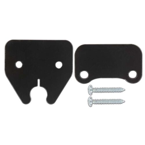

My 2020 Ram did the same thing. fell into my lap while driving. I have the kit $14 Canadian on amazon but i have 3 wires sticking out of the visor that need to be re attached. Not sure why 3. The plug up inside has a brown? black and gray wire which show 12v between the black and grey. The gray is plus. On the visor the 3 wires that disconnected are red, black and blue. Which should go where? Why does it need 3 wires? There's jut the mirror lights and the garge door controller. Anyone have access to a wiring diagram? or know which wire goes where?
Comment Image
So I used the kit I got and it does hold the visor. Not sure why I got 4 screws and they were counter sink but the bracket wasn't and it came in 2 pieces. I designed my own as one piece with counter sunk bracket and 3 printed it in PETG. Seems to be working OK so far. Not sure how to attatch the SLT file so I'll post where it's available. Still haven't figured out the wiring. Guess it will be trial and error and hopefully I don't blow the garage door opener board. (not that I use it anyway)
Comment Image
Here's a pointer to the stl file. Dodge Ram Broken Visor holder by wrayt59
