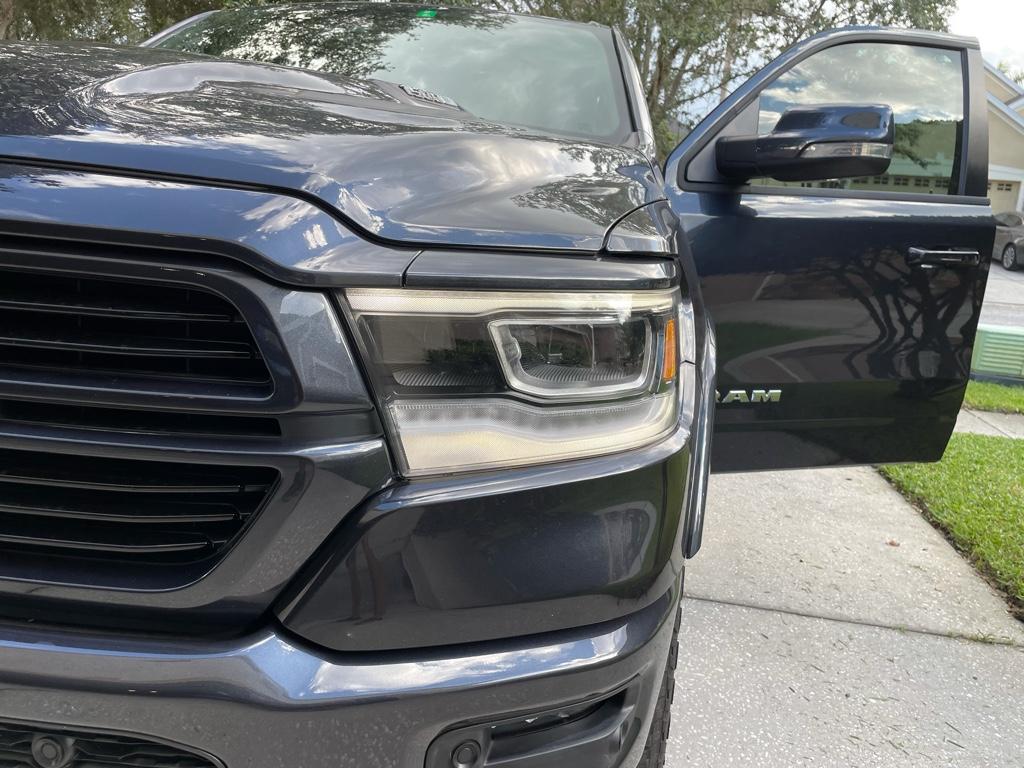

Is it possible to adjust (obd) the brightness of the LED strips in the headlights? I would rather not run the DRLs at dusk and in general.

No, but you can upgrade them.

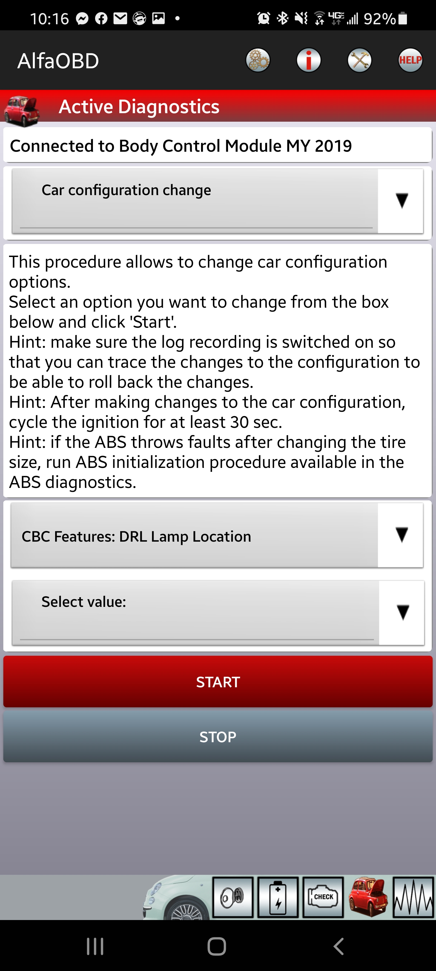

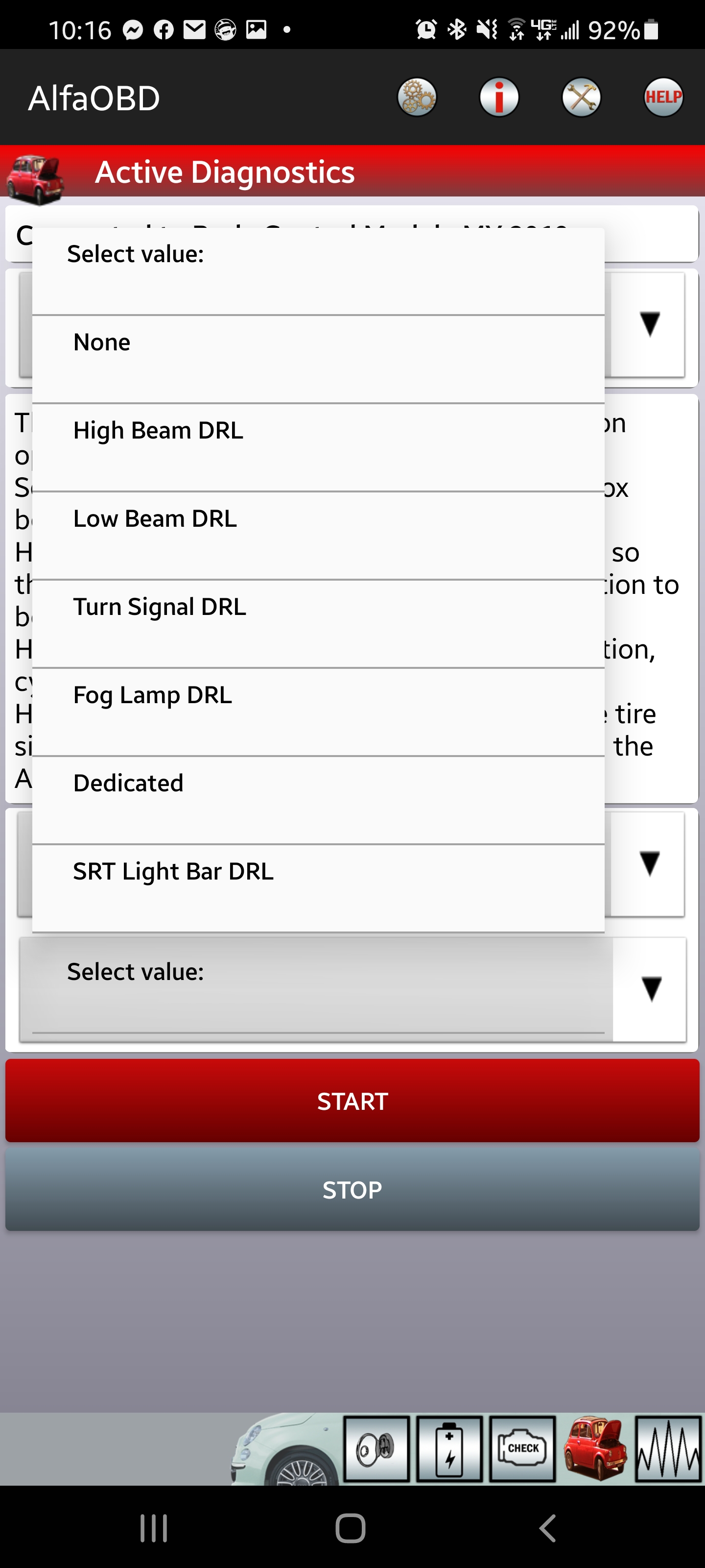

I was going to look into trying to change the led voltage in alphaobd but don't think it's going to be a possibility. Instead, you can run the amber turn signals as drls. They are much brighter. That you CAN do in alpha.

Haven't done it yet. Might try it out in a bit. I believe once you're in BCM, search drl. There's a DRL location option. I've heard fog lights don't work, but I've seen a post where they got turn signals to work.

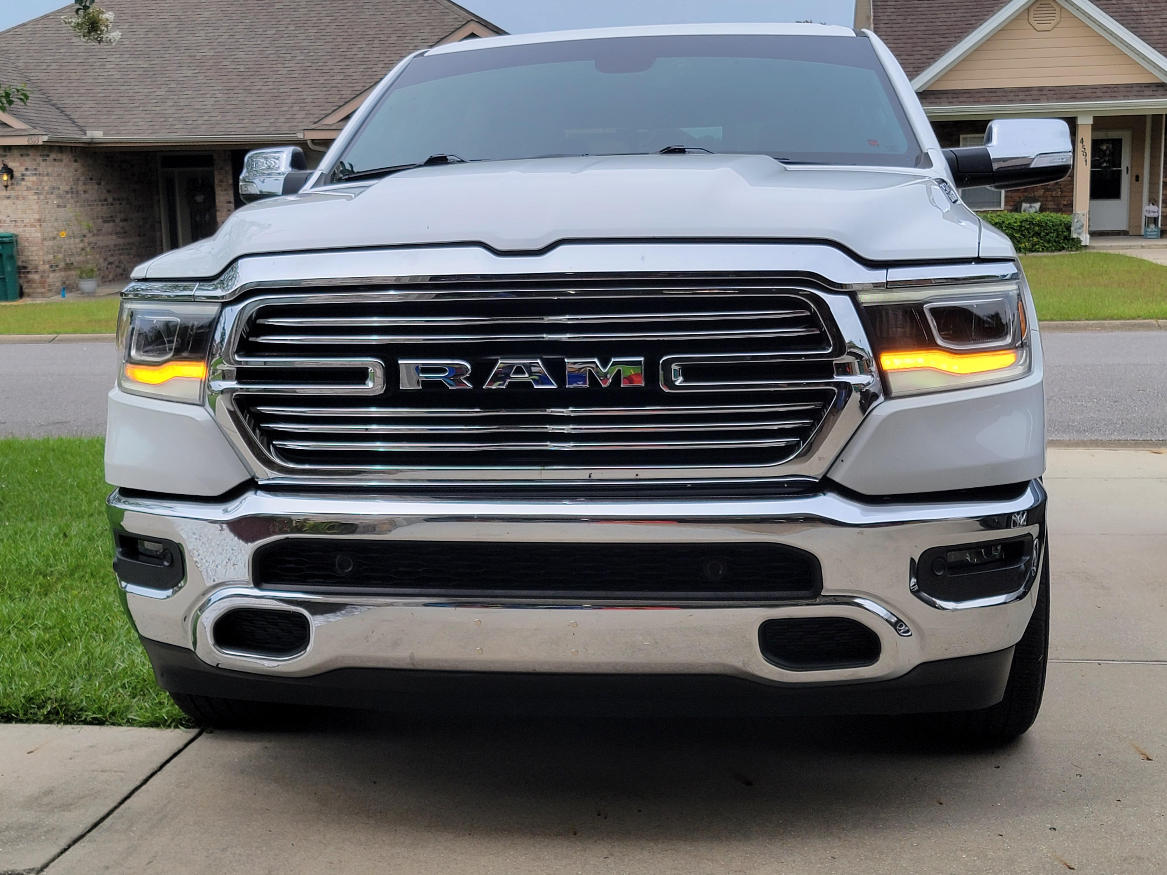

Okay, went out and got it done. Easy stuff. I'm liking it. They are pretty bright. I worry about longevity as these are not cheap to replace which is why I wanted to use the fog lamps. I'll. Leave it for a bit and see if I want to try something aftermarket.
Not much of a video, but wanted to see how the turn signal acts with them set as drls.

Looks pretty good! Were you able to use the fog lights as DRLs using alpha?

So, turn that on. Then go into apfa and update the screen I posted above. Then turn off the truck, lock the doors and walk away for 5-10 minutes. Come back and start it up, turn signal drls should be on.

Sorry, assumed you had it. Worth it for sure. I'm having all kinds of fun with it.
- Disabled drl drop out with high beams
- Added heat when I upgraded mirrors
- added rain sensing wipers
- changed drl locations
Pretty sure there's more. Feel like I learn something new daily
