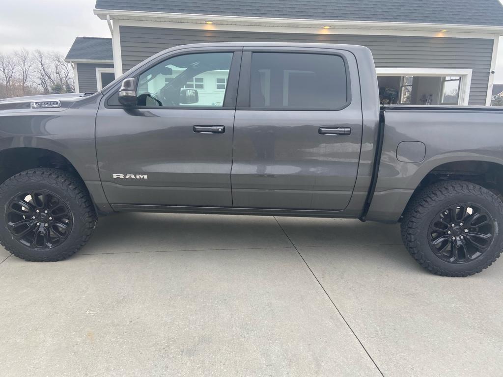

On stock wheels anywhere from 11” to 12” wide will fit fine without rubbing. 12.5 - 13.5 wide will fit on the 9” wide rim fine and look great but you will probably need to do some trimming or wheel spacers. I am running 34x11 with the mopar level kit and off-road package springs (3” lift) and it fits great with no rubbing.

Thanks for the info. Can you post a pic so I can visualize?
Here you go

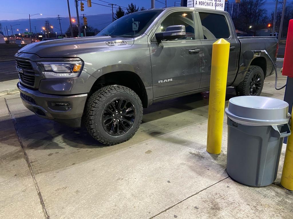

My 275/65r20 rub in reverse full lock on stock wheels with bilsteins set at 2.1”. Every truck seems to be different.
I rub in reverse when doing a tight cut on a 2 inch level with 33x12.5
