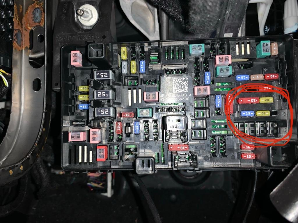

Well... stupid question here...
In my previous 2019 RAM Classic (4h gen), I had two outlets in the front console, one 12V switched outlet (with the ignition) and one 12V direct outlet (always on)... when I do any road trip with my kids and wife, I aways bring my small 12v cooler (thermo-cooler) with thing to drink for the kids that I connect to the 12V direct outlet to keep it running when I do any quick stops (not overnight as well). I was doing the exact same thing in my 2016 Dodge Grand Caravan before the 2019 RAM Classic...
But now in my brand new RAM 1500 Big Horn (level 2) with the front bucket seats, I only found one 12V outlet on the top of the center console which is a switched outlet (with the ignition). I also found as well the two 120V 400W inverter outlet in front console and in the back seat console, but I didn't find any 12V direct outlet anywhere in my truck? Am I drunk or what? Where am I going to plug in my cooler? :confused:
The above dash 12v can be switched to always on by changing a fuse position (I believe f54) on the fuse panel located under the steering wheel (have to remove panel to access)
OMG! This is awesome! I'll dig on that! :cool:
Thank you!!
That yellow one in the circle
Awesome, I'll do that tomorrow and continue to enjoy cold drink in my new truck!! :ROFLMAO:
The one next to the blue one.
Unplug it. Plug it back in so that 1/2 of it is in the hole next to it.
I should mention - my pic is with it at the always on position
Yours will (should) have the gap in between the yellow and blue. Move it over so there’s no gap in between
I even found that this process is even a part of the owner manual officially at page 60!!
