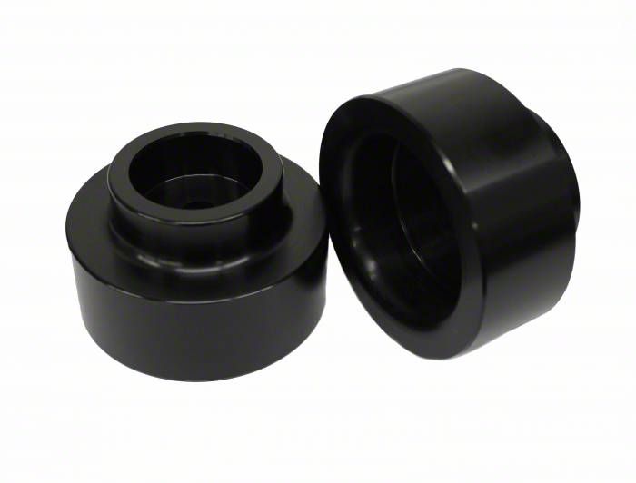

Put a 1" spacer under the rear spring and call it a day if you want a small rake.
It’ll settle down some eventually. To many different variations between different trucks to probably get it spot on 100% of the time. A simple spacer in the rear will get you your rake back. Some rake isn’t bad especially if you have the sport hood.

Do they make .5" spacers that you know of?
Ther is no big difference in them. I don't think you will notice any difference between 1" and .5", only the tape measure can tell.
