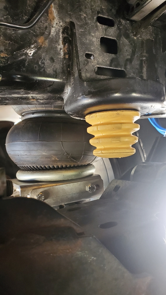

2nd person that has had bottoming out issues, both of you are 4x4. I wonder if my 2wd will have that issue cuz I feel like I have more factory rake. I’m getting helper bags regardless, so it doesn’t bother me...more just curious.
So a bit of information, according to airlift the only kit available made to fit our new body style rams, at least the 2wd is the 60828HD (1000HD). Which is a 2100pnd capacity. I’ll be going with that one, plenty of capability for my use. In conjunction with a hellwig rear sway bar, pedal commander, wheel spacers and probably a drop in filter. Yay allowance from tax returns haha.

Just in case those don't work because of the the lowering springs... These will work. (Air Lift 60824 Air Lift 1000) I have these on mines now and they are approx. 4.0" shorter than the ones made for our trucks. The capacity is much less (1000 lb), but they still will work to keep from bottoming out and I tow with these now. They have been good. Again just a back up in case you need to go with a shorter bag after the 4" drop in the rear. Amazon has them for $87.00

Awesome! I appreciate it, didn’t even think about the length difference from the drop. I may need to get those. My travel trailer is 6500lbs dry, but I also have a good wdh set up so those 1k bags will probably be sufficient. By the way, have you got your drop kit installed yet?

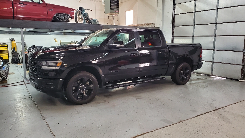

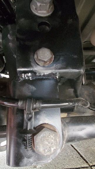

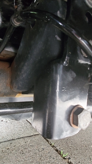

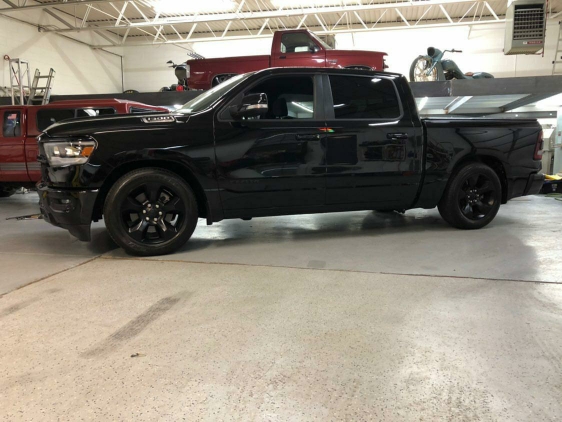

Finally put on my lowering kit. Used the max trac 2/4 kit but went with the 3” setting up front, aligned ok, drop ended up being 3 1/4 up front and 4 1/8 out back.....question is though, anyone else find their trac bar is too long by like 1/4-1/2”? My back drivers side wheel sticks out about a 1/2” and my passenger side is in 1/2” so it’s dog tracking. I contacted max trac and they don’t know why right now. Has anyone else come across this? I’m hoping max trac figures it out cause I really don’t want to shell out for an adjustable trac bar.486B15F4-1391-4764-994E-D0D971BCA590.jpeg

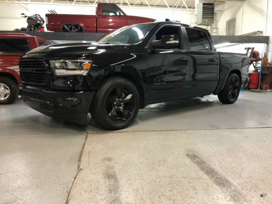

Looks good, I used the same kit along with other parts and ended up setting the front at a 1” drop. My 1/4 sits as pictured here. I have about .5-.75” of rake. I have airlift 1000 helper bags, hellwig sway bar, adjustable end links and adjustable trac bar. I also have ihc 4 link relocation brackets on order. But yes, my left to right centering was off as well. The adjust trac bar fixed that.0DDF34CA-204E-47CA-A798-2E6139C2E5D9.jpeg
Finally put on my lowering kit. Used the max trac 2/4 kit but went with the 3” setting up front, aligned ok, drop ended up being 3 1/4 up front and 4 1/8 out back.....question is though, anyone else find their trac bar is too long by like 1/4-1/2”? My back drivers side wheel sticks out about a 1/2” and my passenger side is in 1/2” so it’s dog tracking. I contacted max trac and they don’t know why right now. Has anyone else come across this? I’m hoping max trac figures it out cause I really don’t want to shell out for an adjustable trac bar.View attachment 58632

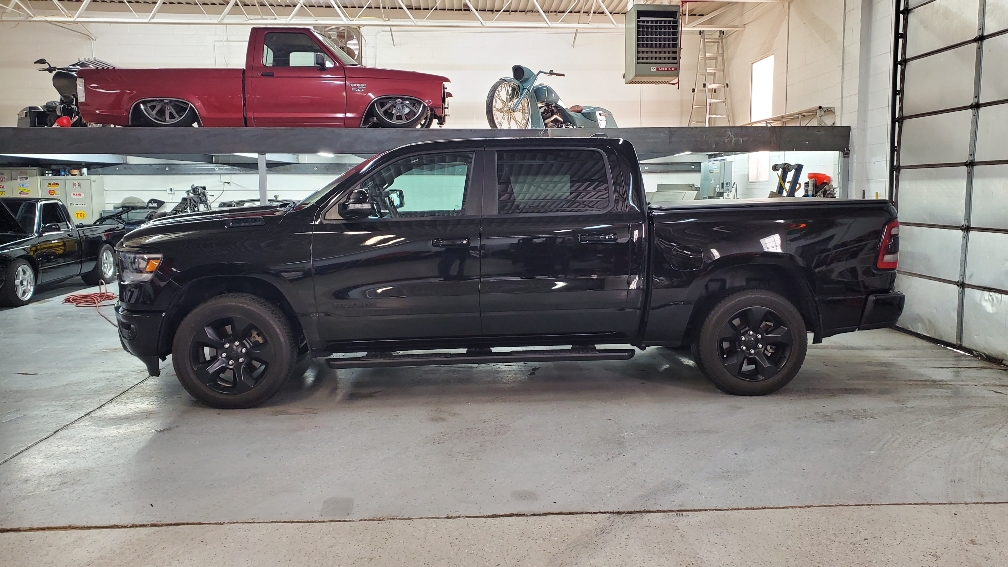

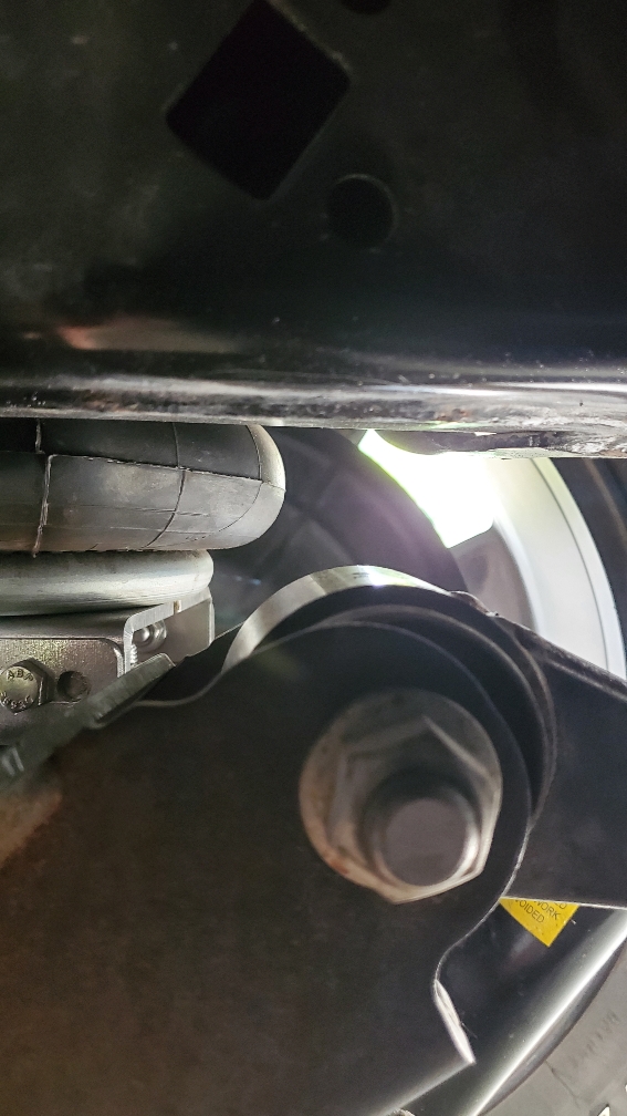

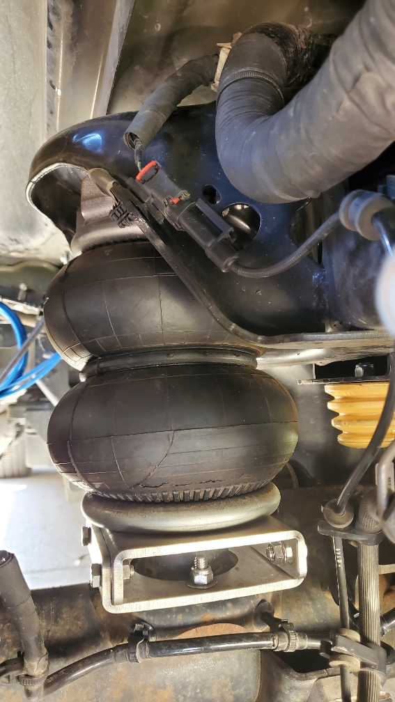

I ran into the same problem with the trac bar bracket when I installed the Timber Grove (6" CRM) air bag setup on mine last week. I didn't notice the issue with the maxtrac springs but the truck wasn't as low either. With the maxtrac kit, my truck ended up going down 3.75" in the rear vs about 4.5" now with the Timber Grove setup. The rear end was shifted over so far that the trac bar bracket was hitting the frame and bottoming out. I ended up cutting the bracket that the trac bar bolts to, off the trac bar mount, moving it over about 1/2" and welding it back on. Rear end is centered now.
Truck is sitting pretty damn level now.. Measurements from the ground to the wheelwell (taken at the center of the wheel center cap) are about 34". This is with stock tires. I took a picture of how much clearance I have between the frame and upper control arm mount. There's about 1.5" clearance. Pretty happy with this setup so far.

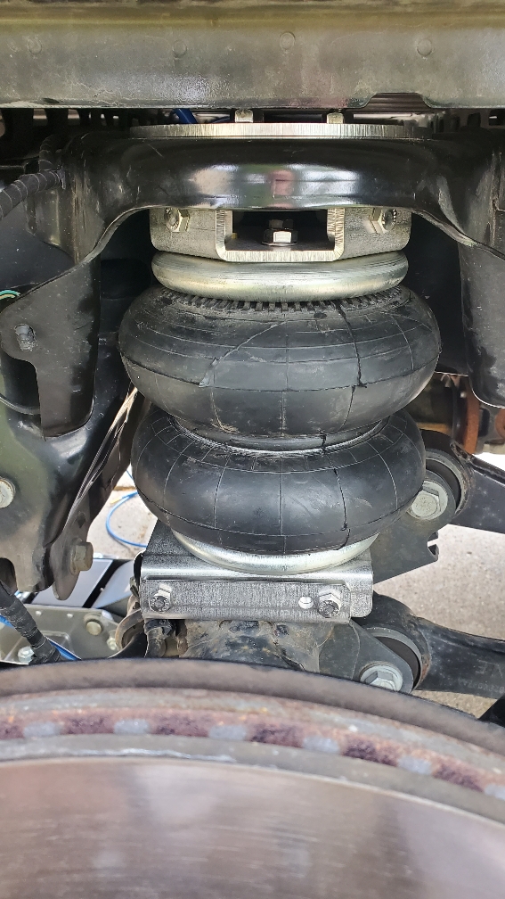

How do you like your bagged rear? Smooth unladen? Good support when loaded? Looks good.
Awesome thanks guys, yeah I’ve spoken with max trac and they weren’t even aware that we all have this problem, let’s see what they come back with but for now I’m going to go for an adjustable trac bar. One of the designers of the kit spoke with me and is going back to the drawing and possibly modify the rear trac bar mount .
So far so good. It's a little stiffer than it should be but thats because I bought the 6" CRM and have to add more air pressure to get up to the 5" drop. I hooked up my boat, I added 5-8 more psi of air to get back to the same ride height. The ride was pretty damn stiff. I may try to fab a bracket to go between his lower mount and the bag to make it sit at 5" with the bag in the sweet spot for air pressure.

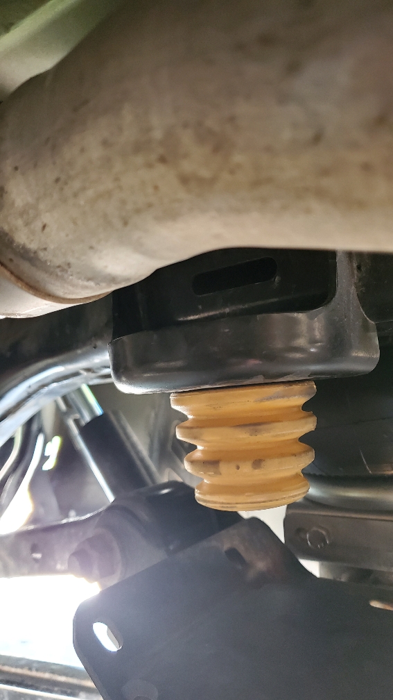

I did also buy some bump stops for it. When the rear sat level with the front, the control arms were tagging the frame pretty often. Since I put the bumpstops in, it's rode pretty nice. I'll be taking the boat out this weekend so I'll try to keep the air a little lower this time to see how the ride is. Hoping the bump stops with the lower pressure is the hot ticket.
I've also read that you kinda need double adjustable shocks with the bags. Thinking about it, it makes sense. The adjustable compression and rebound would really settle down the jouncing action of the bag. So I may also order some vikings for the rear here pretty soon.
