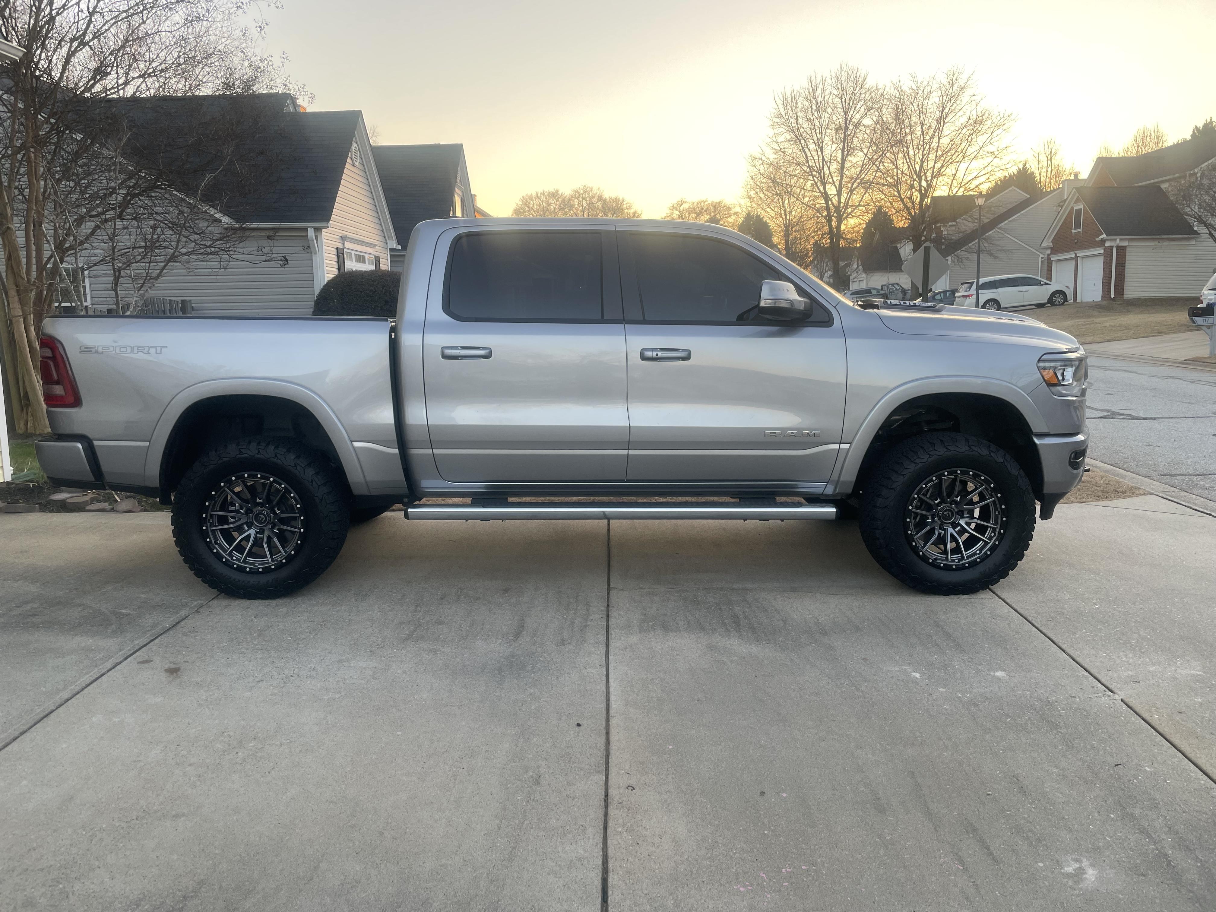

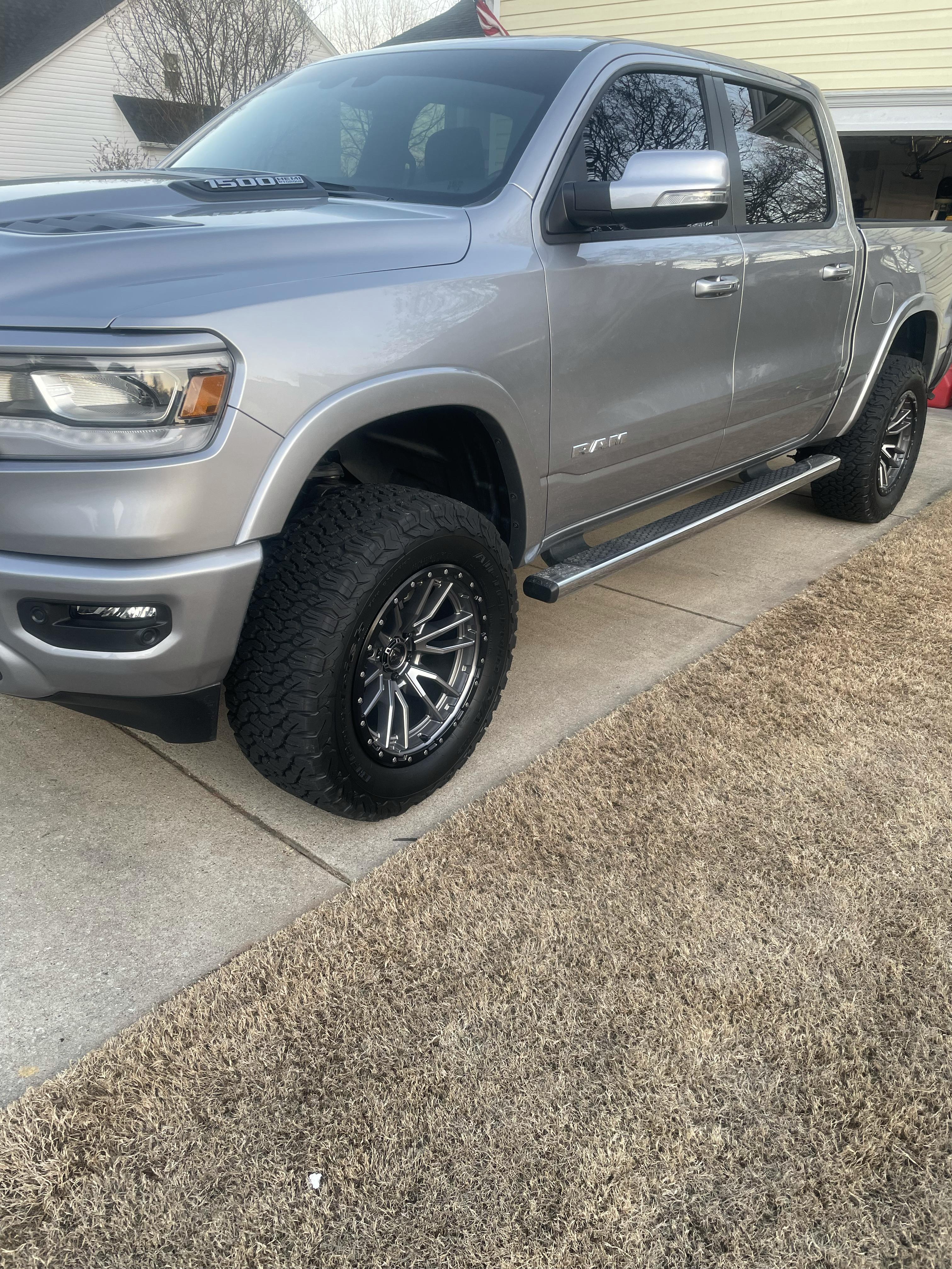

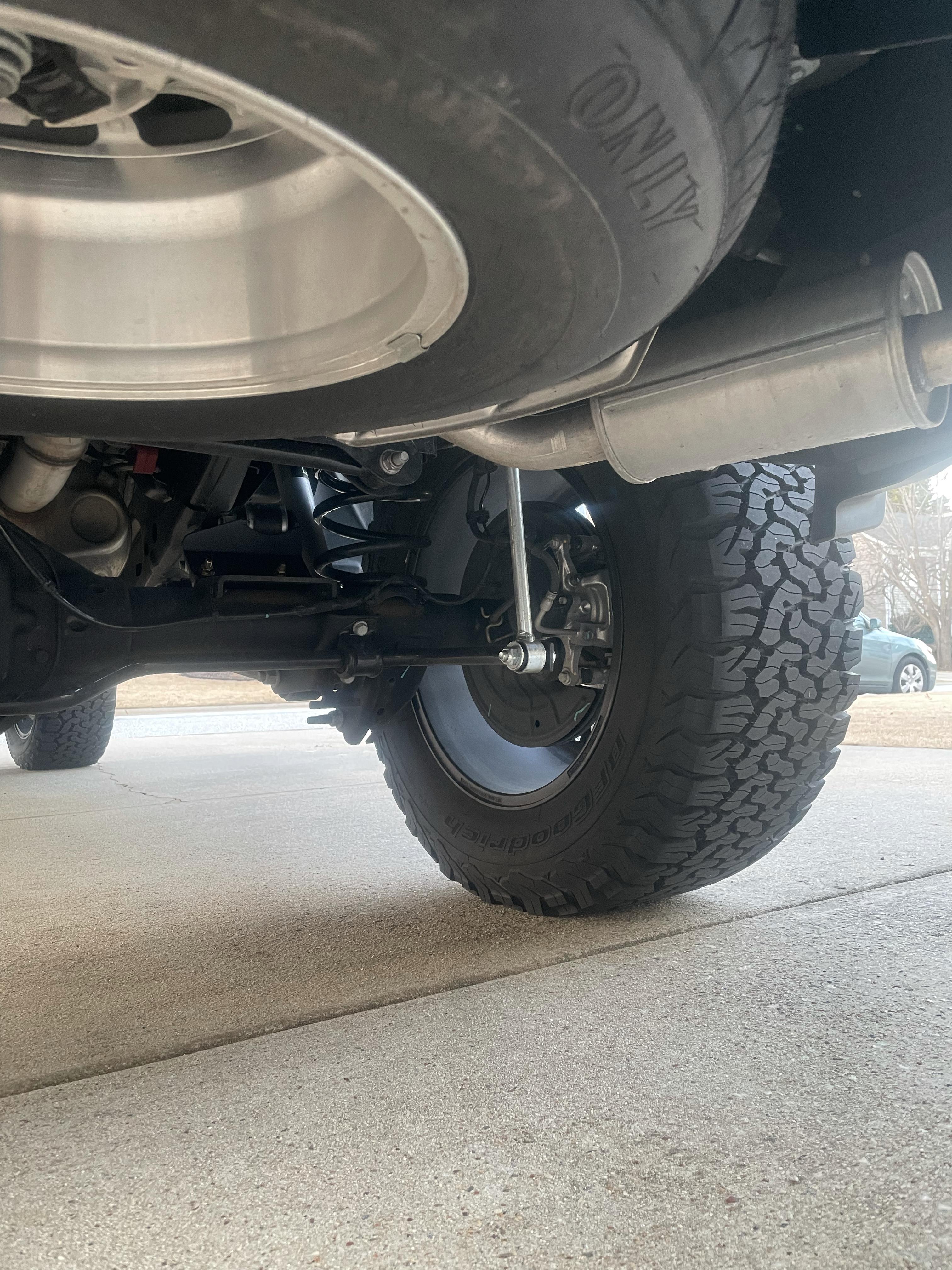

Here's the before and after pictures of the 4" lift with Toyo ATIII 35x12.5/22 tires. 2" spacers were required because the tire was touching the knuckles without them due to the offset of the factory wheels. Overall I think it turned out fantastic. I've got to take it and get one of the wheels balanced again because at low speeds it was fine but on the interstate it has a bad vibration, but other than that I'm 100% satisfied with it. Looks more like an actual truck to me now.
Do you happen to have measurements from the ground to the fender well? Curious how tall the truck sits, considering this lift for my 2020.
