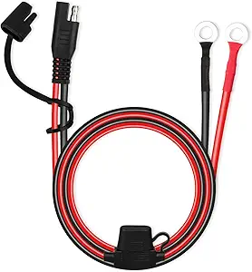

I connect battery maintainers directly to the battery terminals with the quick disconnect terminal leads that comes with the trickle charger; not the alligator clip leads.

I have never looked at my battery to pay attention. I agree with @DEG . A 1 amp maintainer is fine. You don't want to cook the battery.it won't charge a dead battery but will maintain a good one. That connector he pictured is great. On my SxS I put a surface mount one in. Probably don't want to do that to your Ram though.
