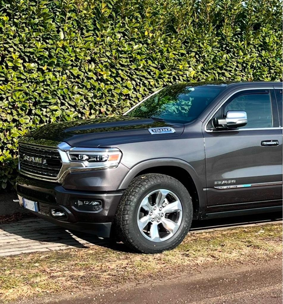

and your ram is an ETorque ?
This is mine:

Yes, the tires are nice but they need to be inflated to 3 Atm and comfort is affected

I drove a Ford Ranger WildTrack (diesel) for just over a year and then (as of December 2024) upgraded to the RAM Limited
Here is mine:
And here dimension
But now I am off topic .... sorry
