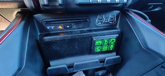

No experience with blue sea but what I see most folks doing including myself is installing either wired or wireless switch system which has control box(has pre-wired relay and fuse protection for each circuit) that goes in engine compartment where you connect all of your switched accessories to then it includes either wired or wireless switch panel that goes in to the cab.
Here is the one wired version I went with. It only uses one small wire to run into the cab. I chose the wired version because the wireless was more expensive and the switch panels tend to be more bulky.
