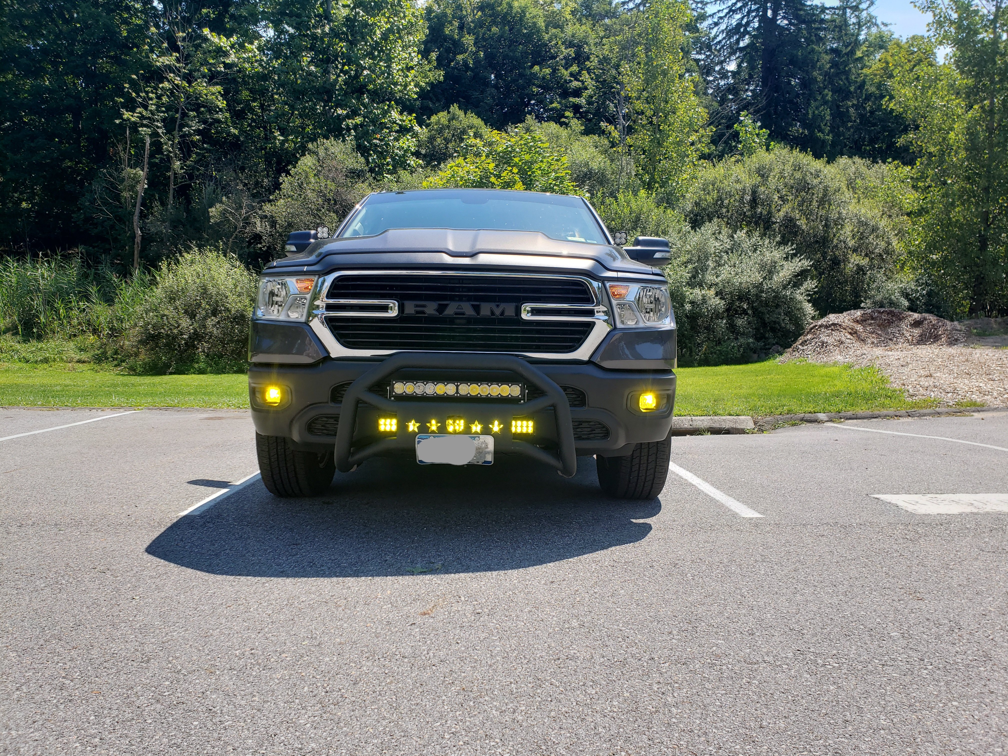

I really like my baja s2's feel free to ask me any questions I will help the best I can.
I really like how small are your spot lights, they look very nice! I also assume that you simply screwed them to the bumper without any special brackets? The only negative side I see so far is that these lights are super-dupper-expensive at 175$ USD each (+shipping since I am in Canada)!! OMG!! o_O

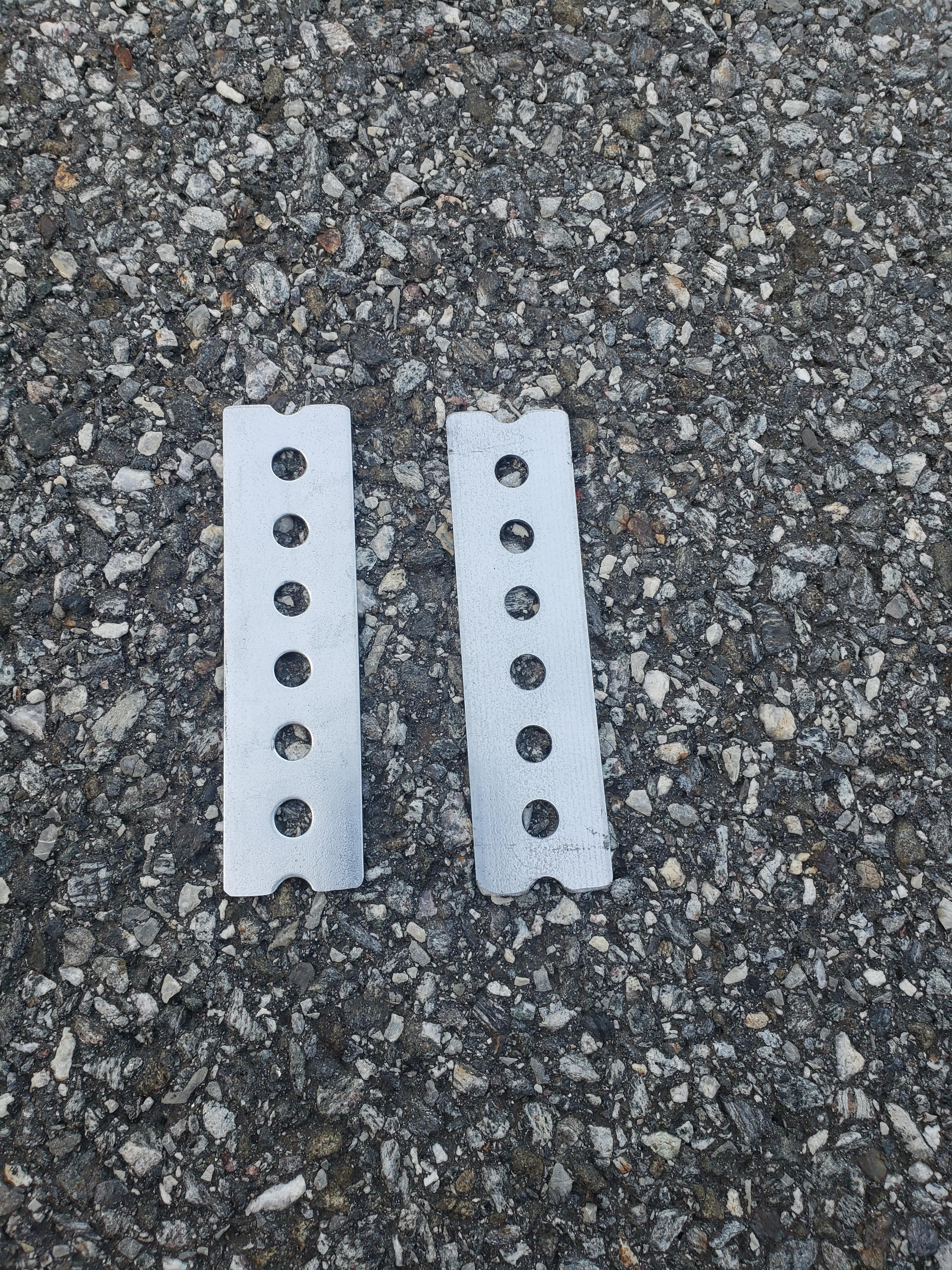

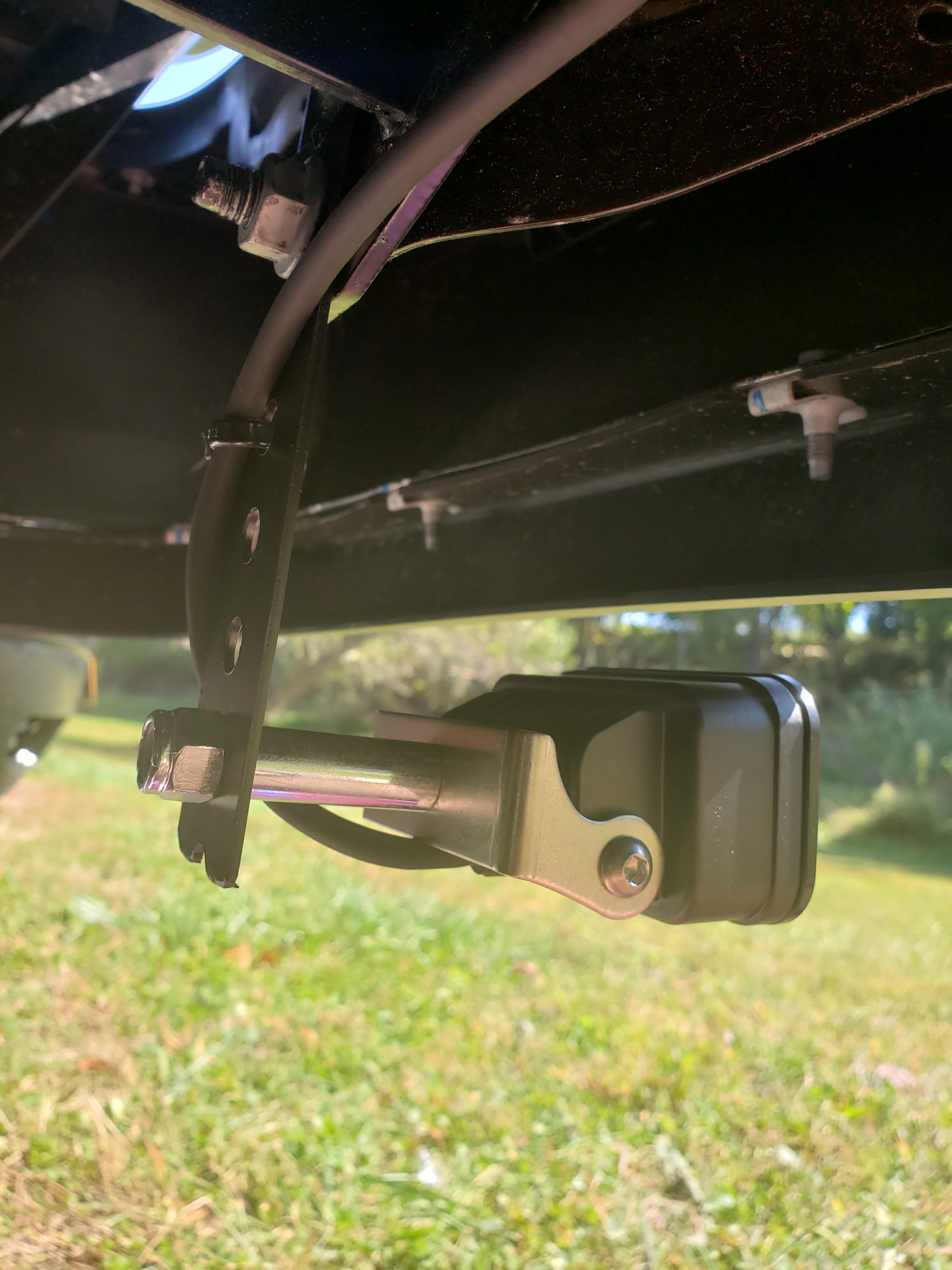

I fabricated brackets from the hardware store. Yes they are expensive but I believe in buy once cry once if you have the funds of course. Lifetime warranty and they are warmer white instead of most lights that are the cool white with hint of the blue. Check out some of my other lighting videos I have on my YouTube, I also have the baja lightbar and hood lights.
And those large studs I see on your photos where you mounted your plate is the hitch mounting studs I assume? I just looked at my own Big Horn and I was to say that it's not really possible to mount anything on the bumper itself because of this black plastic trim/molding where I have the backup sensors on mine because it's super flimsy and thin. Thanks again! :cool:
In conclusion you really found a way to make a "no-drill" installation on your truck, this is awesome!!
Yes the nut you see at the top of my bracket is the hitch mount. You don't need the bajas just anything size wise you like.
