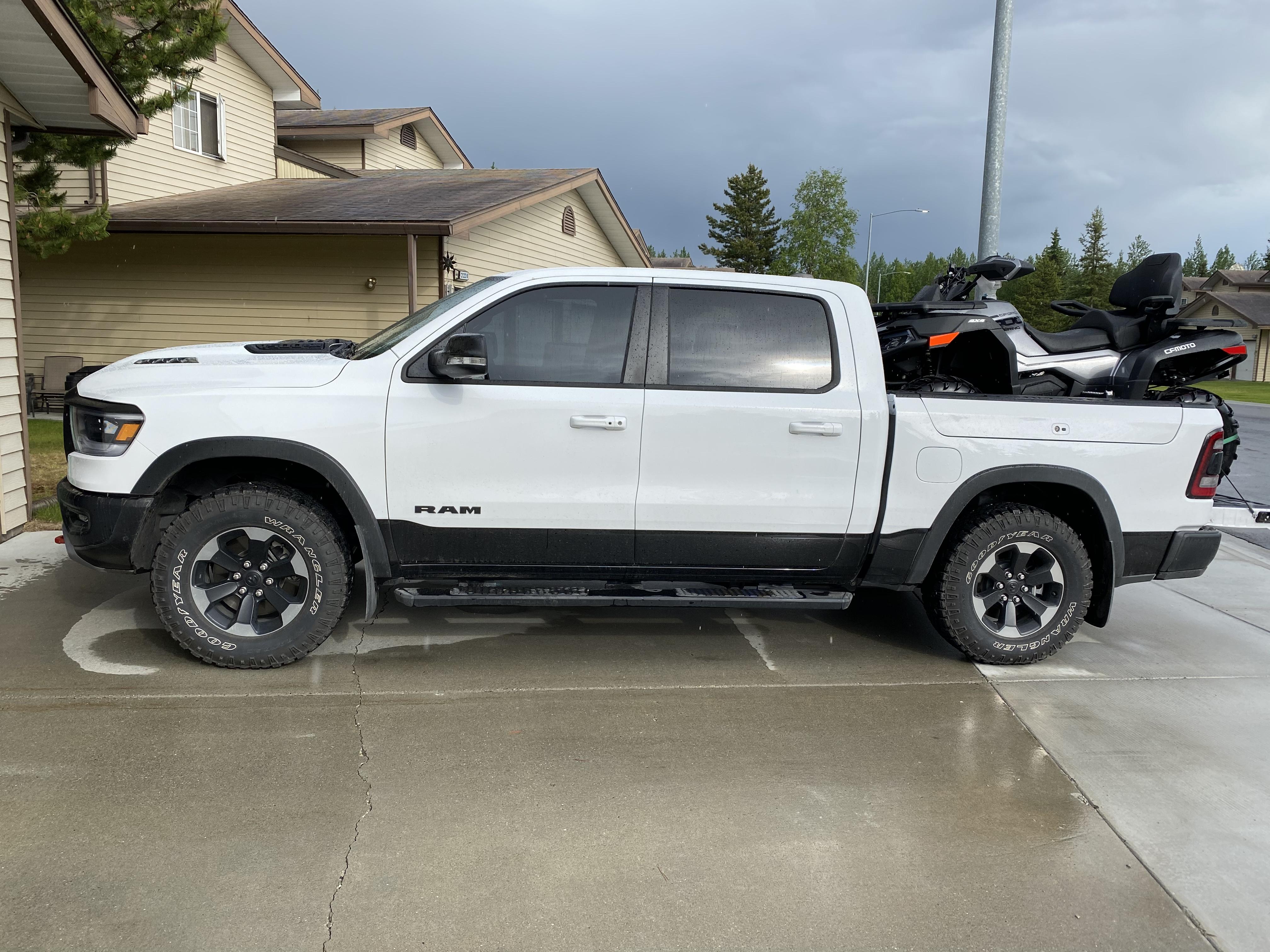

Does anyone put a 50” ATV or UTV in their 5’7” bed with RamBoxes?
2021 Honda Pioneer 520 - 50” wide SxS, fits inside the 2020 Ram 1500 Sport with 5’7” Rambox. 2” lift, and multifunctional tailgate with after market tailgate support. The Tonneau cover is removed for the SxS and there is no wiggle room in the box. The Honda Pioneer 520 factor tires rub against the bottom tie downs without issue. Tonneau cover is left on for hauling a 129” sled in the winter, it sticks out a bit but who cares, saves hauling the trailer around if I can help it.
Did you pull the rails off for the cover?
Finally. Seeing a pic (thanks for posting) that shows that a 520 can be loaded into a RAM equipped with Rambox. I am looking at the new 2500 rebel 6.4 ft bed with rambox and was hoping my pioneer 520 would fit. This photo gives me hope that it will. Anyone else been successful with Rambox?
