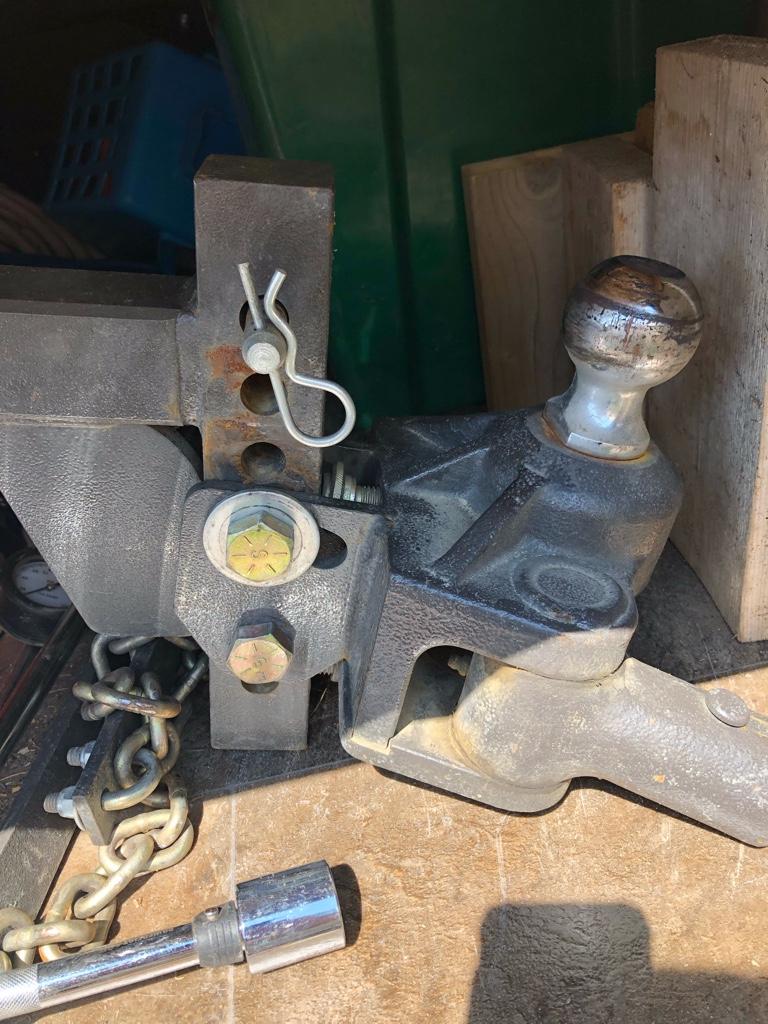

My trailer is at just under 1000lb TW and I’ve got the 1200lb bars on my blue ox. Had the 1000lb before and they couldn’t handle the job to my liking. The step up was perfect.
Are you running the SwayPro? I don’t believe they sell a 1200lb bar for that hitch. You may be running the 1500 bars.
Previous version of the blue ox that I’m running from 2013 had 1200lb bars. The newer version doesn’t, and the also eliminated the hitch head micro tilt adjustment. I’d go 1500lb with the new setup for sure.

Here’s my hitch head for reference.
