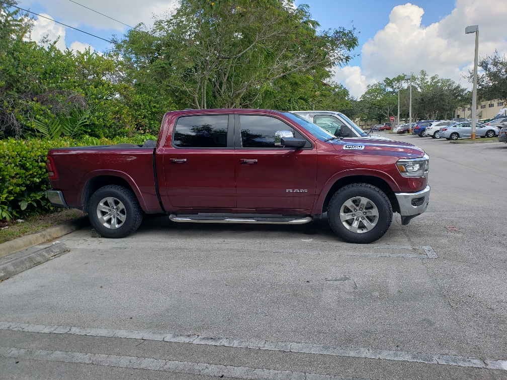

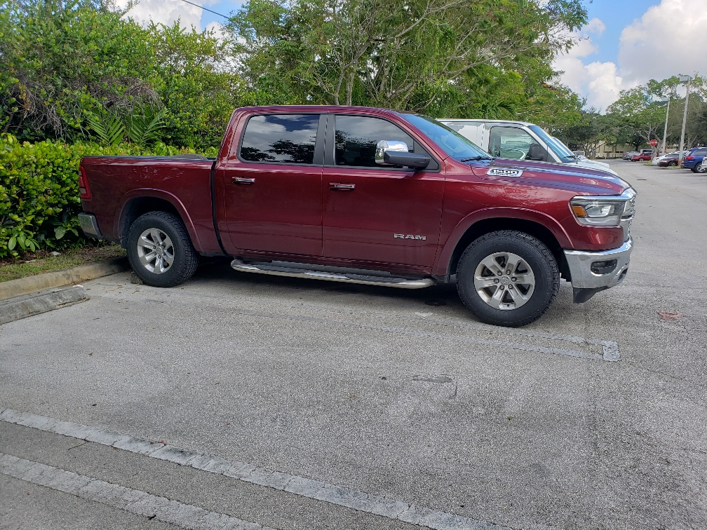

275/70/18 Kenda Klever A/T
All stock
Thanks for posting these pictures! Think I’m gonna go back to my 18 inch wheels with 275/70R18’s. Will probably go with some Bilstein shocks to level it out.
If I didn’t have this BDS I would have stayed with that set up.
