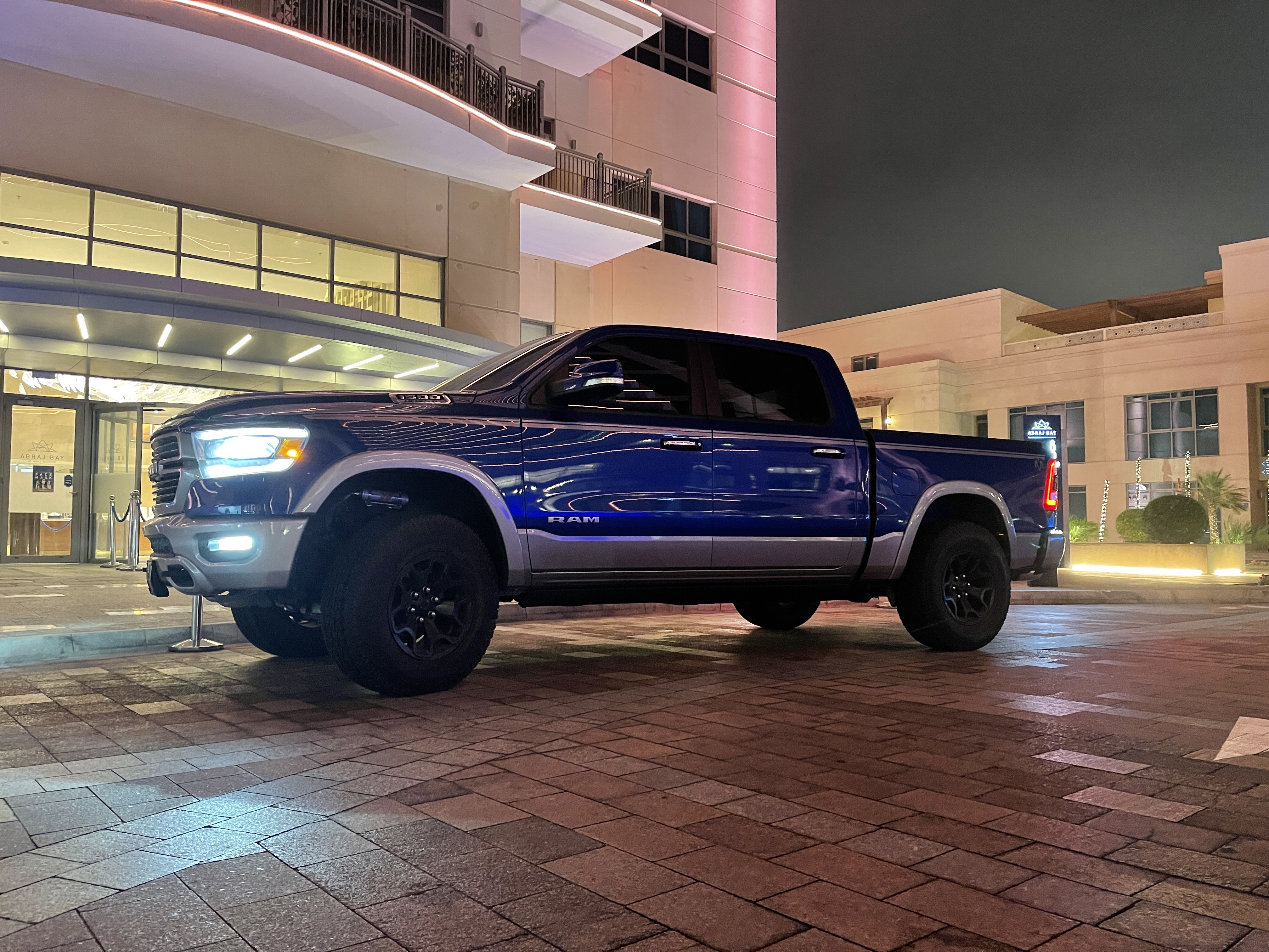

There are pictures of my car in the forum,
I’ve found out the hard way went with 3” front and 2” spacer kit while waiting for my Carlis King package to arrive.
Then added 2” spacers as the tires I went with were 295/65/18 and they were rubbing with the UCA with full extension of the suspension, with the spacers required additional trimming to the rear inner liners.
Get the wheels with 275/65/18 and you won’t need anything else.
We keep pushing for the biggest oem size but yet we keep altering minor modifications here and there.
