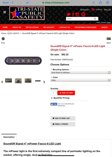

This is exactly what I have been thinking of doing. Can you send a link to the lights and spacers? Nice work!
The lights I bought from Tri State. The wedges I found on eBay. Just a heads up. I bought the ones with the rear studs but if you use the wedge, buy the one with the tape mount. I had to cut the studs off for it to work.
