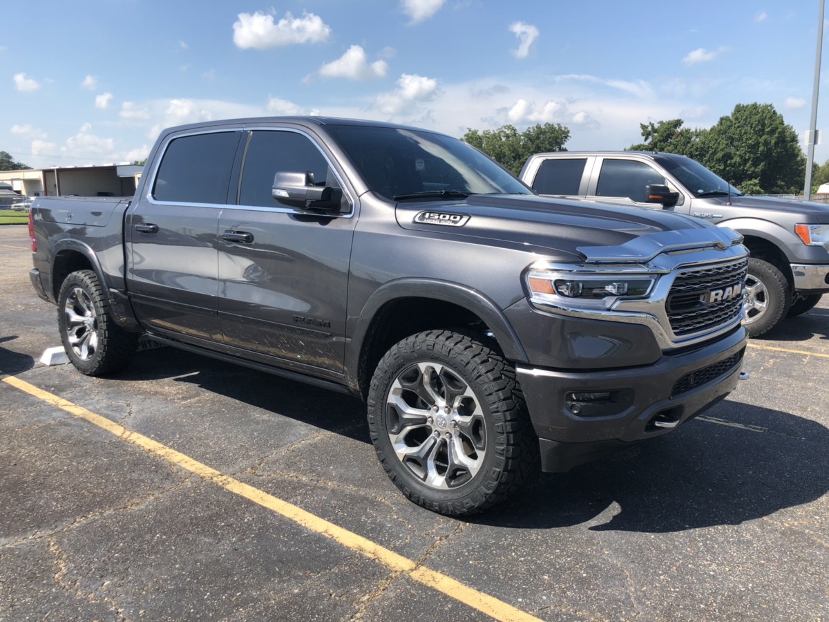

Just thought I would share as many others have done some pics and details of my leveled Ram. If not for this forum I wouldn’t have discovered the ‘work around’ to level my Limited. For anyone considering this Mod I would simply say go for it. I couldn’t be happier with the outcome and the ride is like driving on a pillow....
Revel Links front only measuring 2.25 inches eye to eye.... truck is dead nuts level. I might try the rear links that came with the kit and bring up the rear 1/2”.
Daystar 2.5” Spacer up front.... drove for 2 weeks without these and links only and all I can say is night and day difference.
Toyo open country All terrains 295/60R20 on RBP 20x9 Rims with zero offset. All in all gives the truck an aggressive stance with a really comfortable ride and minimal road noise. Went for the chrome rims that looked a little like the OEM rims because my last truck was all blacked out and I wanted something different.
All air ride modes work as normal and all the pics are in the ‘normal’ setting. No rubbing in any mode.
Enjoy.....

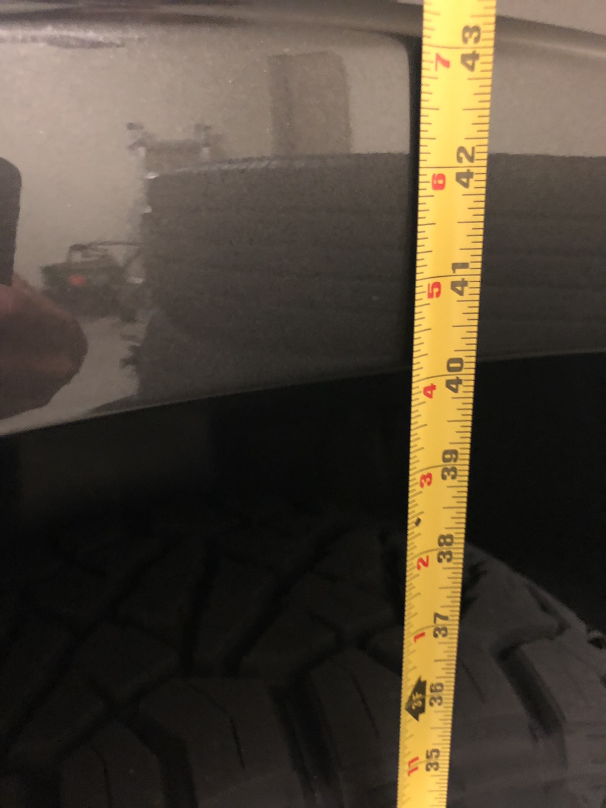

Bay area ram, is there any rubbing at all and do you have wheel spacers? I have your level height with mopar lift with mods. Thinking about using your tire size. Beautiful ride !!
barakutha
Jun 30, 2019
280
455

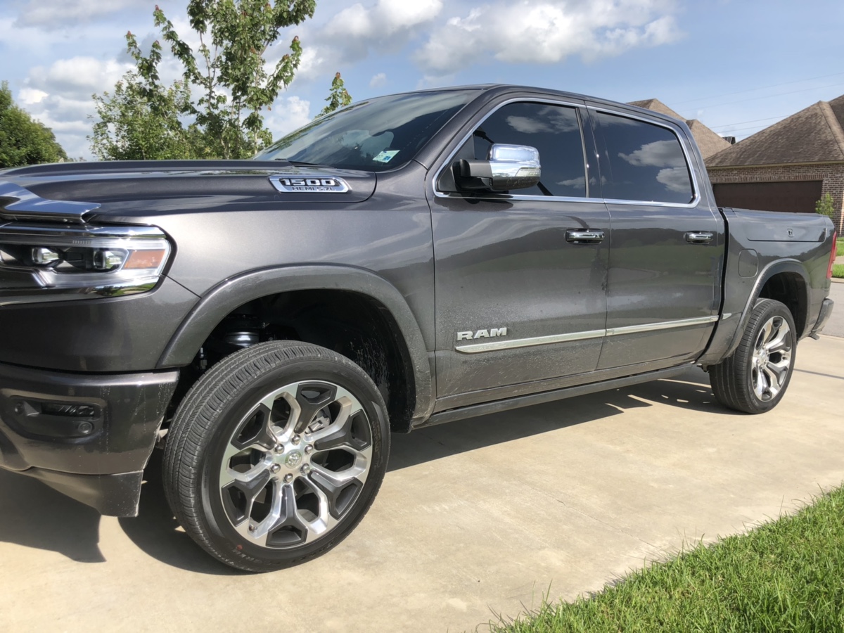

Front in normal
Rear
Stock 285/40r22s (31 inches)
Ridge grapplers 285/55r22 (34.6 inches)
No rub in aero or normal. I'm loving it so far
No rubbing in any air ride mode forward or backwards. There is one spot that might make contact ( picture the mudflat plastic piece to the rear of the front fender closest to your feet) if your in aero and turned really sharp but that would be unlikely and it's easily fixed by taking a 1/4" off with an exacto knife. I had to do that anyway with almost every lifted truck I've ever owned.
No wheel spacers either.... I wouldn't trust them especially since I tow with the truck. My opinion is they're not needed... zero offset and the tires barely stick out of the fender flare. I'm super happy....
Enjoy.....
Super nice... Really like those wheels.
