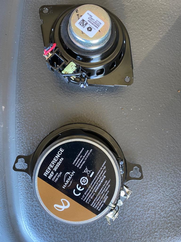

I have the Alpine 9 speaker system and getting ready to install the Infinity 3032s dash corners tomorrow and Crutchfield says to make sure I wire in the 270 Microfarad capacitors that came with the speakers. WHAT?? What was the purpose of buying the plug in adapters if I have to cut, splice, and tape these bad boys in the + side. Anyone do this???
If I don't use them, what is the outcome? I see several posts by people who just plugged in the adapters and had no problems.

Did you use the capacitors on the + side that came with the speakers?
Weird. I bought the same speakers and they were already soldered into place between the positive blade and the wire running inside the speaker....no other capacitor was in the package and they sound great.

those arent the capacitors. They are in the bottom of the styrofoam packaging. Much larger black cylinders. 1621084822160.png
