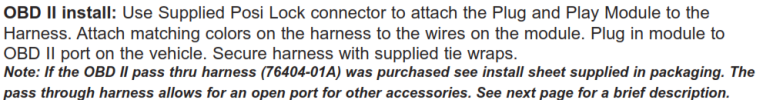

Picture of the 2 connections Real Truck tech support provided below. As above, shows the white wire connected to the truck blue/white stripe, blue wire connected to truck white. Install instructions on pg 8 and 9 state:
The second instruction would seem to contradict both the first instruction and picture, but I'm wondering if this might explain the reversal noted in jokel76 post? If these are the door open/close signal lines, then perhaps blue-blue and white-white would avoid the reversal. Pg9, which contains the 2nd instruction, is a direct transplant from the pre-2025 install instructions for 76240-01A powersteps. I don't believe the 76404-01A pass through harness will work on the 2025 with its new software architecture. Did you guys try this harness? Plan to query AMP Research tech support on this.
