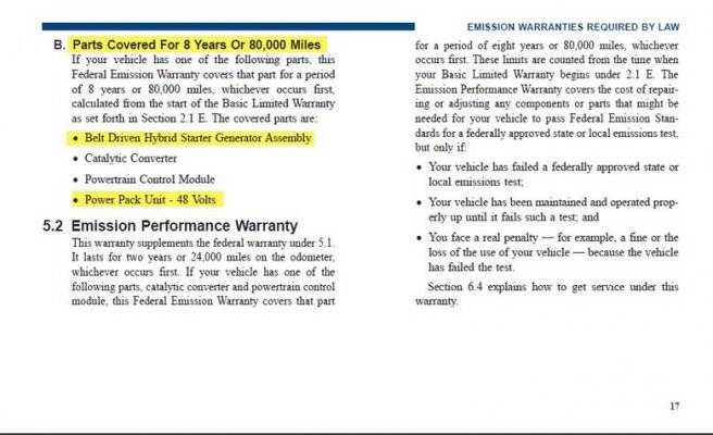

Etorque is warrantied for 8 years I think so you might check with the dealer.

Looks like it would be covered tho
