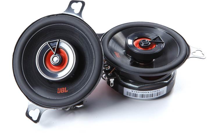

Overall pretty happy with the Alpine system but looking to replace the front dash speakers.
Anyone know the resistance of the front dash speakers? I saw the base system are 8 ohm but have not seen for the Alpine.
Know the factory amp output to each speaker with Alpine system?
Trying to match ohms even if it means soldering a resistor in.
Looking at the Kenwood Excelon 3.5", they are 4 ohm and only 83db sensitivity.
On the Alpine system all speakers are 2 ohm, but you don't have to match impedance, there are a few 2 and 3 ohm speakers out there.
Thanks, that helped a lot knowing the ohm rating.
Knowing factory speakers are 2 ohms, I ended up getting these and some 600 Hz high pass crossovers. Their sensitivity is OK and ohm rating close to the factory. Total was $42 after my rewards points and a $15 gift certificate code I had due to shipping problems on an order last summer. Bought the speakers and crossovers open box.
I just couldn't justify the price for the Infinity Reference considering they are not on sale right now (I've had them in previous vehicles, usually bought them around Thanksgiving when 50% off, though this past year they were only 25% off).
Thinking of just disconnecting the middle front dash speaker after installing these.
The GX are a bit better than the Club ones, but that's ok.
The JBL look the same as the Infinity but they sound much better in my opinion, i have the JBL GTO 329 on mine pushing over 100 watts to them and they sound amazing, they are sold out everywhere though.
The centre channel has it's purpose just keep it there, the left and right channel will overpower it but it's needed for the Android auto or Apple play
Looks like the GX and Club are basically the same, except Club are 3 ohms and GX are 2.3. Though I was unable to find the composition of the woofer and twtter, or the shape of the tweeter, for the GX. I think both are synthetic woofer with rubber surround, and semi dome slik tweeter, but not sure. The GX aren't listed on JBL's website. I think with the crossover they'll be great.

GX has a better coil. less impedance and can handle more power.

Have you tried the JBL GX 3.5 in your dash?
