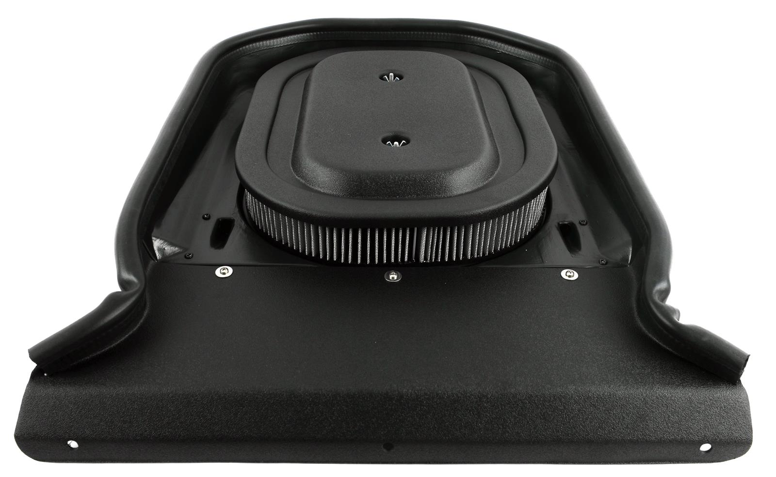

I’m looking at doing the same thing, but lately it’s been way too hot outside for projects. But I think it could fit pretty easily on the passenger side of the engine pay. I’m possibly thinking about swapping to the ram air intake and mounting it where the stock air box lives.

That honestly sounds perfect, I never considered it there since I’m think if switching to an S&B since the ram air intake (if its the mopar one) is a bit rich for my blood haha.

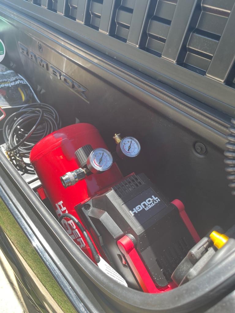

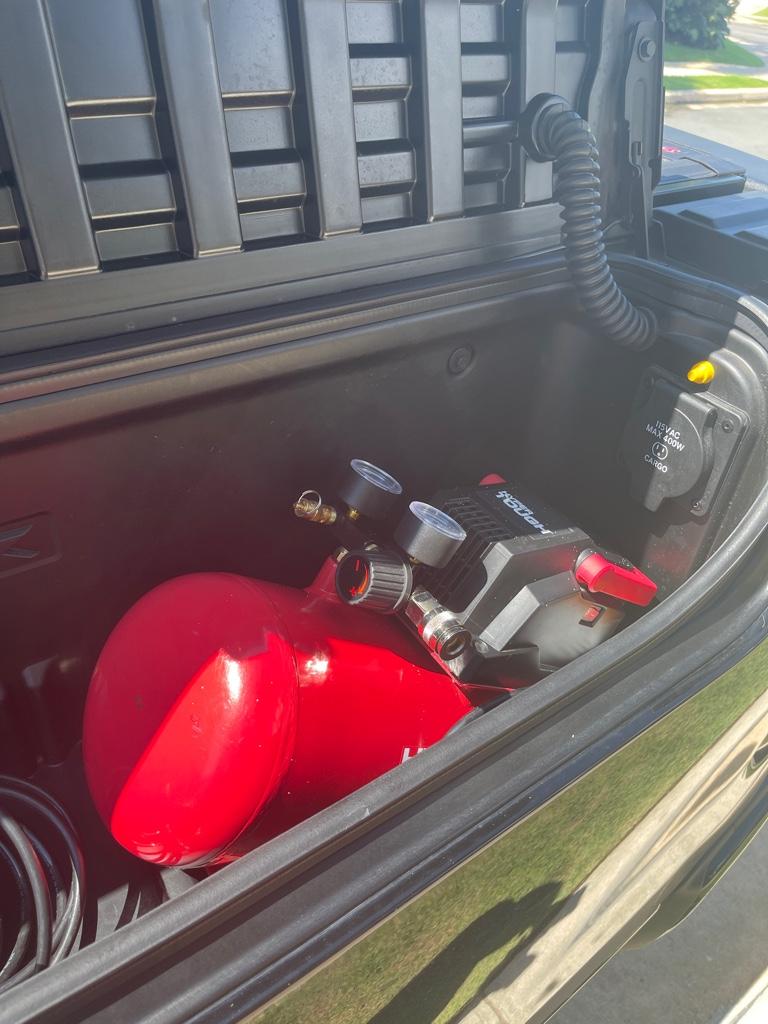

Ended up buying a Hyper Tough 3 gallon compressor that I saw out of coincidence, got it from the dad of a buddy of mine for 40 bucks at it fits perfectly in the RamBox where my AC plug is at.

So I have mine where your air intake filter would be I installed a ram air which opens up that entire side of the engine bay and installed a 2-1/2 gallon tank with the compressor since I don’t have ram boxes , works out great because of the ram air which isn’t a an insane amount of money to get and fairly easy to install
