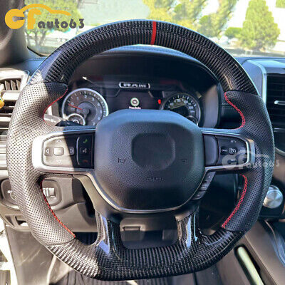

Anyone did any after market steering wheel swap? Came across this on ebay and i think i might grab it and see how everything will fit, can prob get from alibaba for like 200 bucks as well LOL

Just an update on this post, the ebay seller got back to me and my steering wheel got shipped. Here is the pic he sent me of it. So it seems that this one is straight plug and play with heated connector included so no modification is needed.steering wheel 1.jpgsteering wheel 2.jpg
