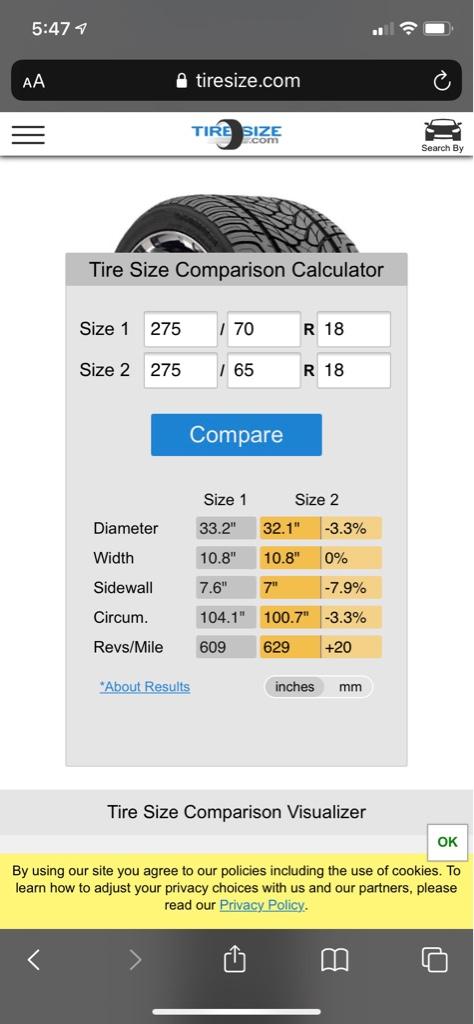

I’m picking up a new set of rebel tires/rims to add to my bighorn later today. Couldn’t pass up a killer deal. Does the change from stock to bigger wheels mess with the tire pressure warning in the settings? Also, how far off will the speedo be once complete?
Thanks for any insight!

I did the same thing with my big horn and if it has sensor in them they will work but the pressures are different in the rebel tires, i used a tazer DT to update my tire size and tpms sensor settings so if it drops below 40 now it lets me know. I believe the speedometer will be off around 2 mph at 60mph
That chart should be accurate new tires are 3.3% bigger
Hope this helps!
Put mine on about 6 months ago...zero issues with the sensors so far
