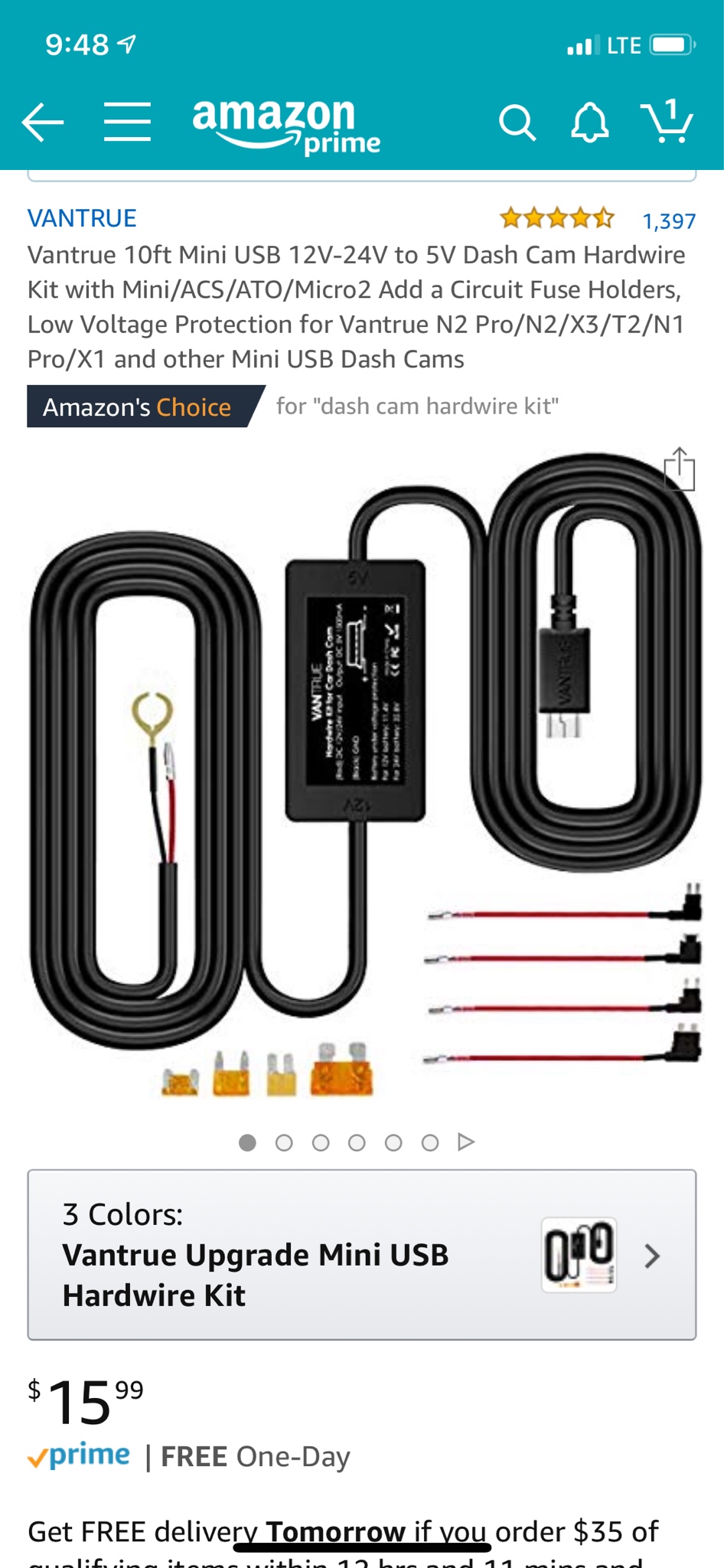

I’m not 100% sure if you are talking about this but I used the kit on the pic to wire a dash cam and it worked perfectly 100% plug&play
This is what I was looking for, a product referral from someone who used an actual product in the fuse box. Just as a follow-up, which fuse cavity did you plug it into?
Thanks very much for your help on this.
I used https://www.amazon.com/gp/product/B07D9K4K2T/ref=oh_aui_search_detailpage?ie=UTF8&psc=1 for a dash cam hardwire. I can’t remember which fuse but I found the info on this forum. I remember it was in the lower right corner. I will say it was very tight because it barely fit within the raised plastic rim but it did work. If you can’t find the post with the fuse number repost and I will pull my cover and look. Fuses are getting tiny. You need micro pliers to pull and set them.
If you just need to hook up an extra power wire and don't need the dash cam wire, this is what you want:
micro add a fuse
You need the micro fuse size...
