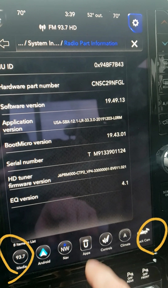

My truck info :
- 5th Gen 2019 Ram 1500 Laramie
- 12" UAX radio
- HW PN: CNSC29NFGL
- Application Version: v 33.3.0
(USA-SBX-12.1-LR-33.3.0-20191203-LORM)

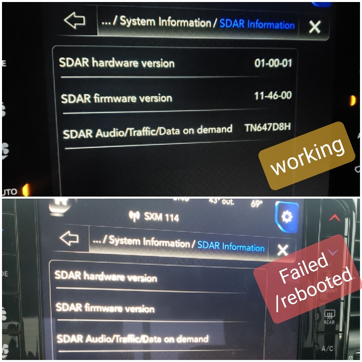

** I do believe that the issue is related to the SXM/Satellite module (SDARS) which faults out and causes the Reboot. Specifically...
>> If I go into DEALER MENU when SXM is working, you can see that the Following info is populated....
- SDAR hardware version: 01-00-01
- SDAR firmware version: 11-46-00
- SDAR Audio/Traffic/Data on Demand: TN647D8H
>> When I check this screen after it faults out/reboots ... SXM is greyed out & " Unavailable" it doesn't show any SDARS info (Just blanks):
** To access DEALER MENU : hold the 2 Lower, Outside App Icons at the bottom of the screen for 6-10 secs **

Dealer Menu - Radio Info
Dealer Menu - SDARS info

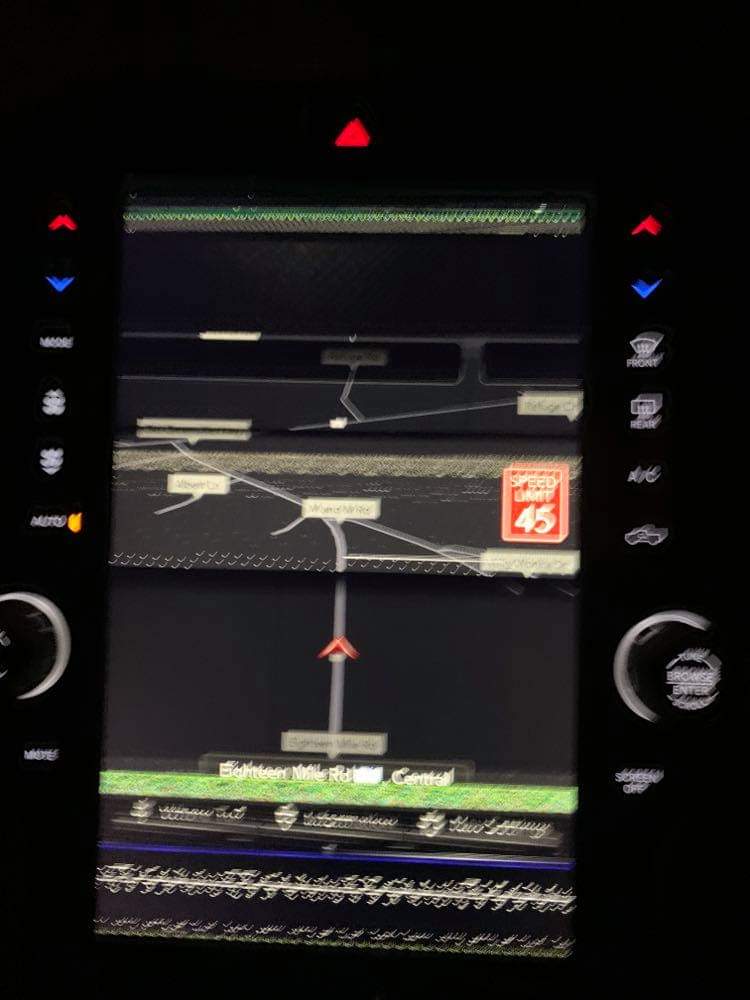

Screen Error switching from AA to Nav
