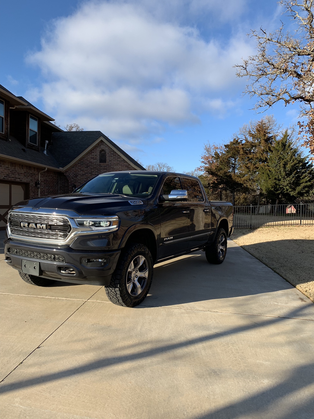

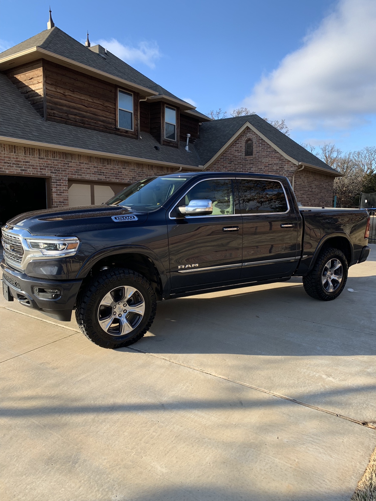

They should clear. I’m running 295/70r18s (34.5x11.50) on stock wheels and have room to spare on a 2” level. Might be close but should clear
@Tjhook Are you running that size on stock suspension? or the 2in lift? I want to run this combo on 4x4 Off road with air suspension.
I am looking to do the same setup. I thought I would need to get new wheels, but your rig looks great with the stock wheels. No spacers?
