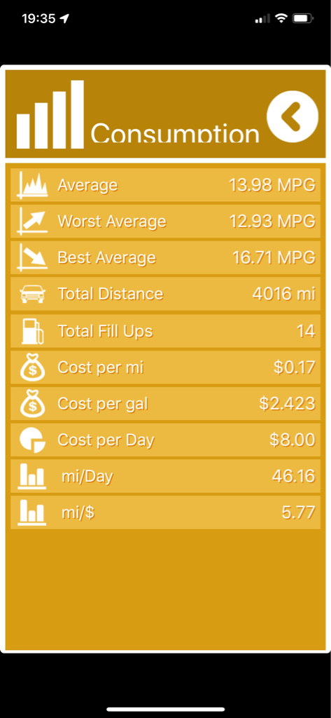

This is 35-12.50’s on stock wheels, limited, 5.7 non-ETorque, leveled front.
