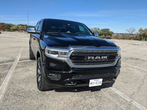

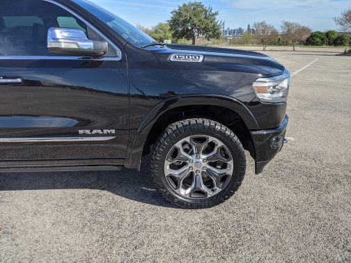

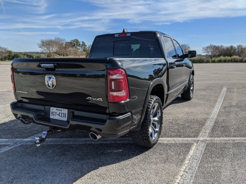

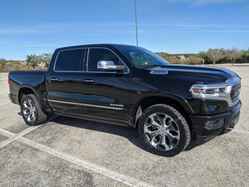

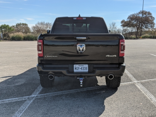

Put these Ridge Grapplers on last week so thought I would share some pics

Definitely a much improved look from the factory 285 set up.
Stock air suspension? Any rubbing?

Looks nice. How’s the diameter compared to the Goodyears? Did you have to recal the speedo?

I love the setup looks great! Quick q: those tires (305/45/22) support a 9.5-11.5in wheel but the limited 22's are 9 inches. My dealer said they wouldn't mount my wheels on the 305/45/22 tires because it's a safety concern. I asked a local tire shop and they said no also. Wondering how you got it done?

Here's how it went down. I went to Discount Tire and told them I was looking at AT tires - they looked a the truck and recommended this size in the Ridge Grapplers. I asked if there were any concerns about rubbing, throwing rocks that would hit the paint, etc. they said no, so we ordered them. I asked again before they installed them if there was any issue with this size on the factory rims, and they said no...
Now that you mention it though, I do remember seeing that they were made to for 9.5-11.5" rims, so I might call them tomorrow to double check. I definitely dont want any safety issues. But I love them so far!

They are around a little less than an inch larger in diameter. The speedometer is only off around 1 mph @ 65, so I doubt I will recal it.

Actually, Discount TIre's website lists them as supporting 9.0-11.5" rims:
