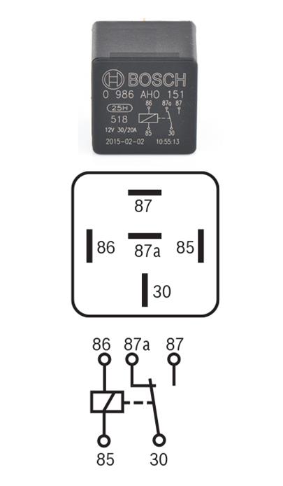

I know I've seen it somewhere here but can't find it now. I am wanting to hook-up my driving lights to turn on with my high beams but also want to be able to turn them on separately without using the highbeams. Can someone point me in a direction? Thanks!
Get a five pin Bosch relay. Pin 86 goes to your aux switch. Pin 85 goes to ground. Pin 87 goes to battery for the new lights. Pin 87a goes to the high beam wires. Pin 30 goes to the driving lights.
