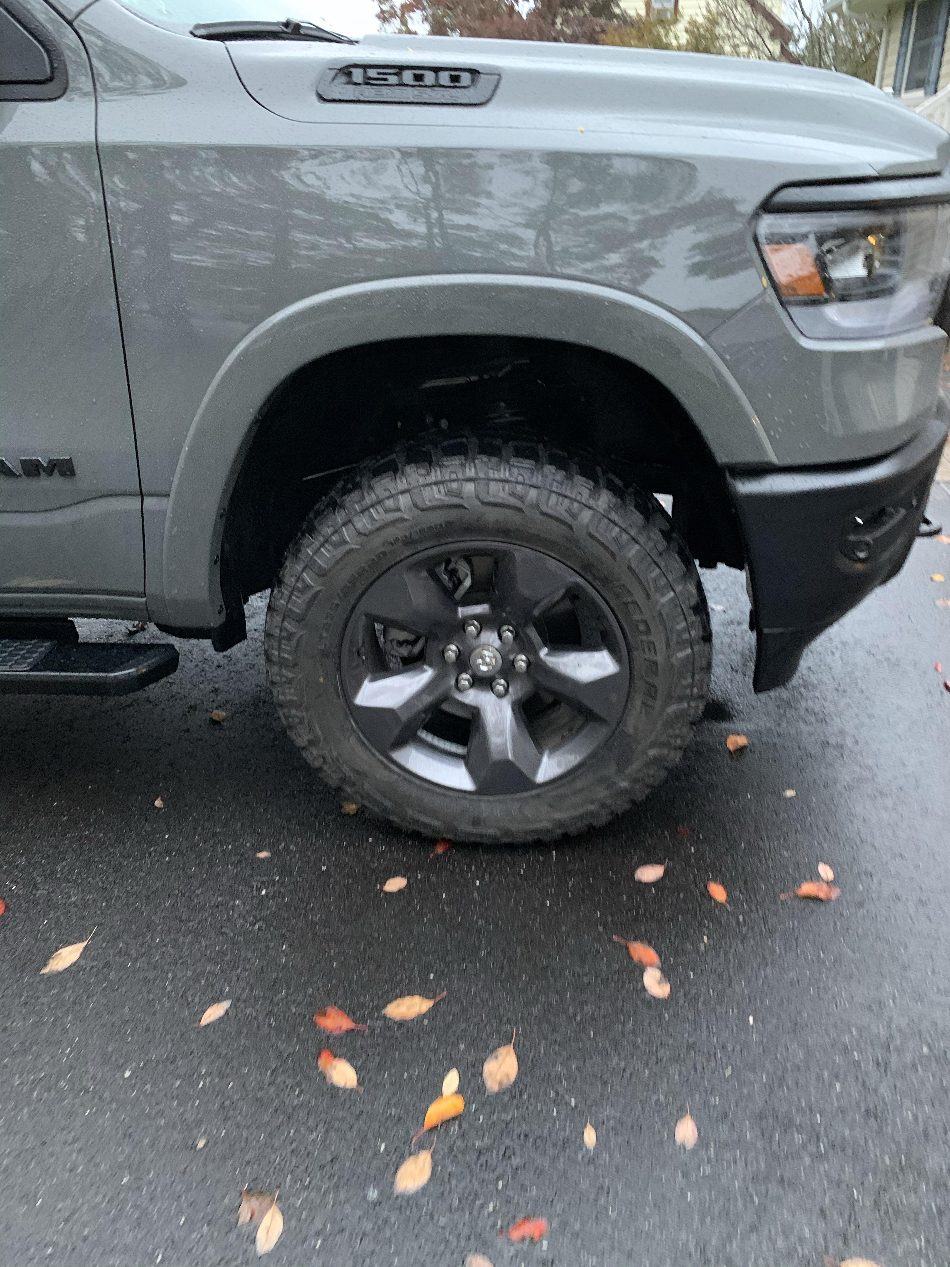

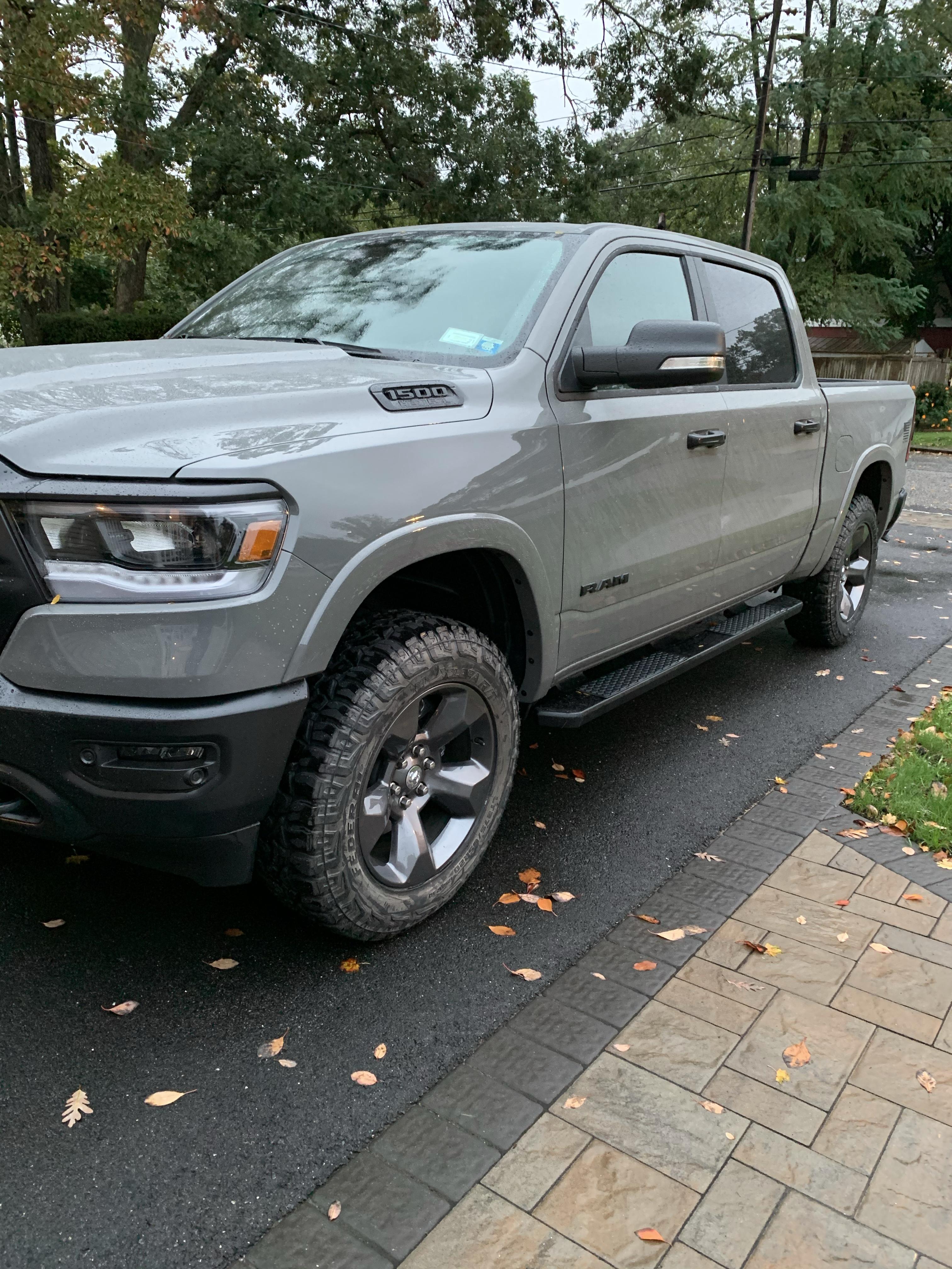

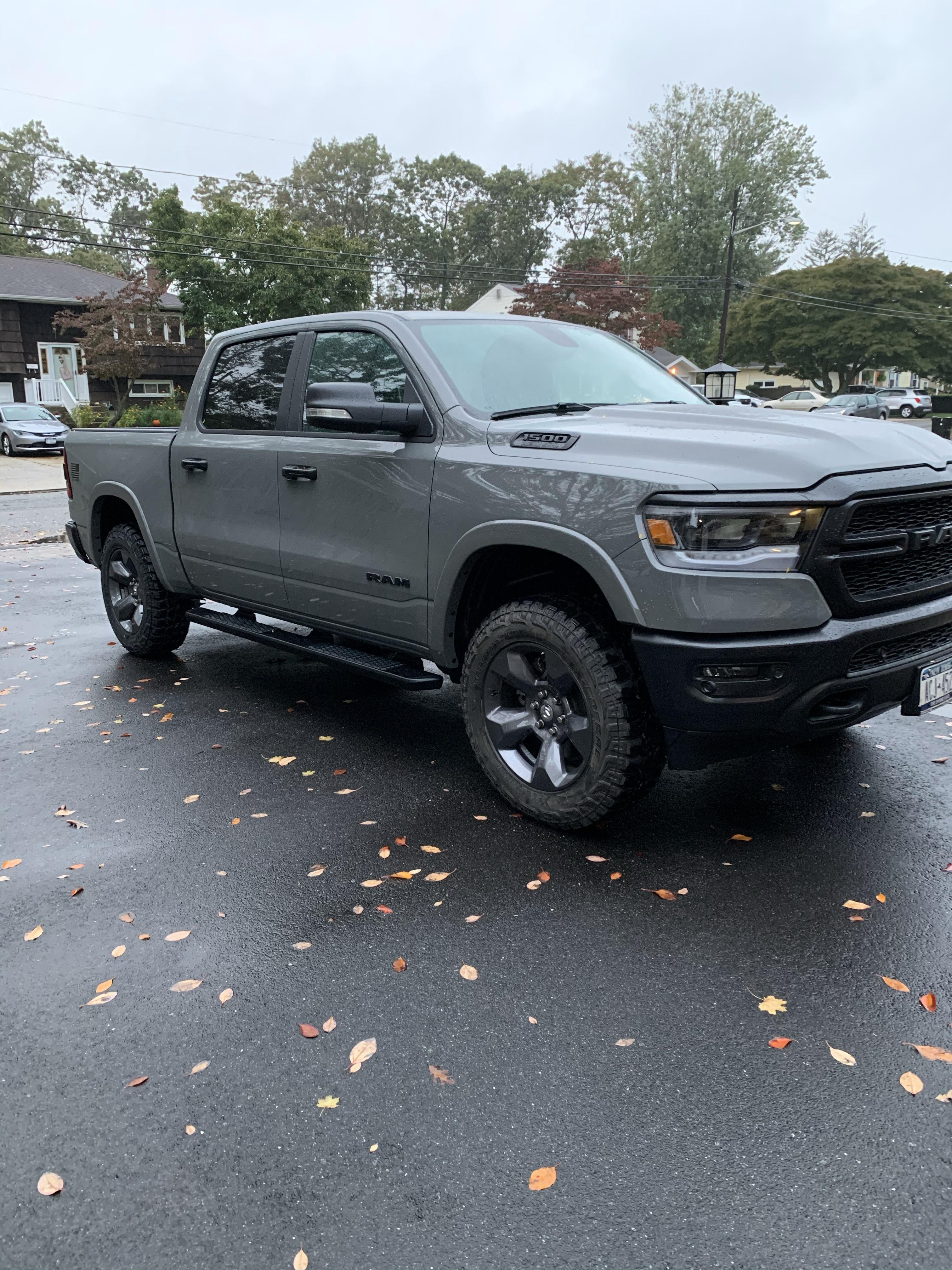

Subbed, need pics @puba08
Your truck in the profile pic still has the stock tires
Here you go
Love the tire choice BTW, this is the same tire and size I decided to replace my AT3WAs with. Thanks for the confirmation pic, def gonna get these tires soon
What kind of lift did you go with?
Had the Motofab 2” spacers and Zone UCA’s installed originally. I already had the UCA’s that I never installed on my 4th Gen. Needless to say the ride was absolutely awful with the spacers. All sorts of noises and bangs were coming from the front end. The truck rode like sh!t. I wasn’t expecting the best ride with spacers but saw others raving about them and took the cheaper way out.
So those had to go ASAP! Couldn’t order 5100’s anywhere (which was weird?). So I saw someone mention the Eibach shocks. I new about their shocks and springs from the other forum. So...I ordered them as I didn’t want to wait for the Bils to get restocked in every place I looked. I got the Eibachs for $215 shipped for the pair.
I had them installed (I don’t mess with spring compressors) and the ride is perfect! I highly recommend them. I set them at the 3rd setting (@1.8”) because I have the ORP which nets 1” from the springs. Gave me a 3” lift/level which is exactly what I wanted.
