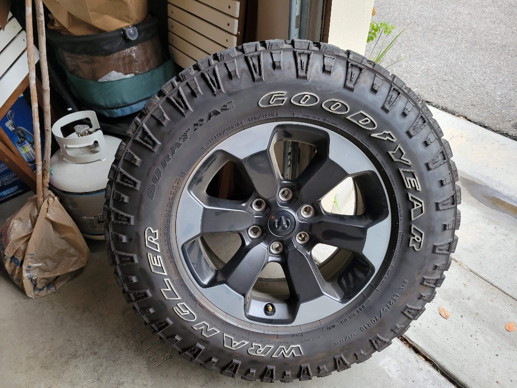

Are you in SoCal by any chance? I have a set of Rebel wheels and tires I took off my Rebel. They have only 8400 miles on them

I'm in NorCal :( ... and think I'm going to move to 20" wheel with more variety in tires - staying away from LT as I don't need that heavy of a tire. You'll certainly have no problem selling your set though!
