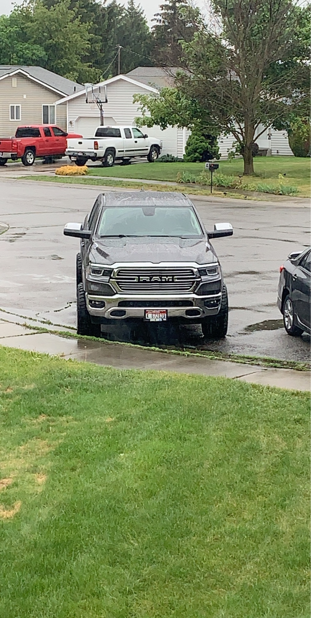

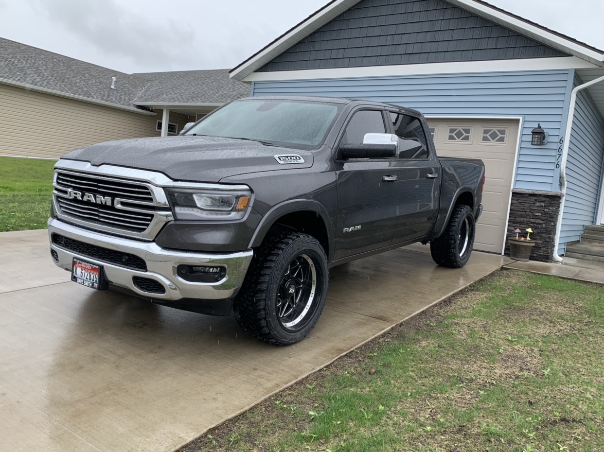

Finally got everything installed today after getting back home from work. I definitely rub, but not nearly as bad as I was expecting. I will post more pics shortly, but I just snapped this after pulling it out of the shop. The front sat higher at first until it settled.

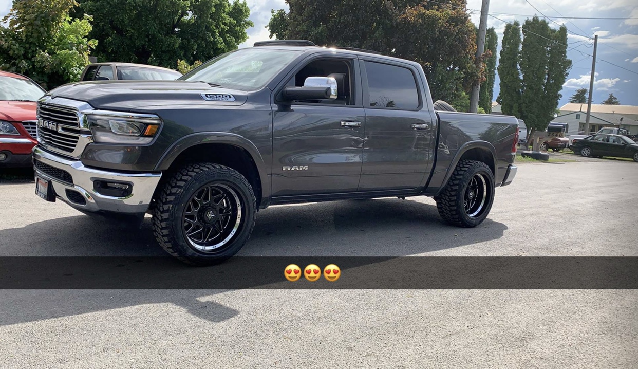

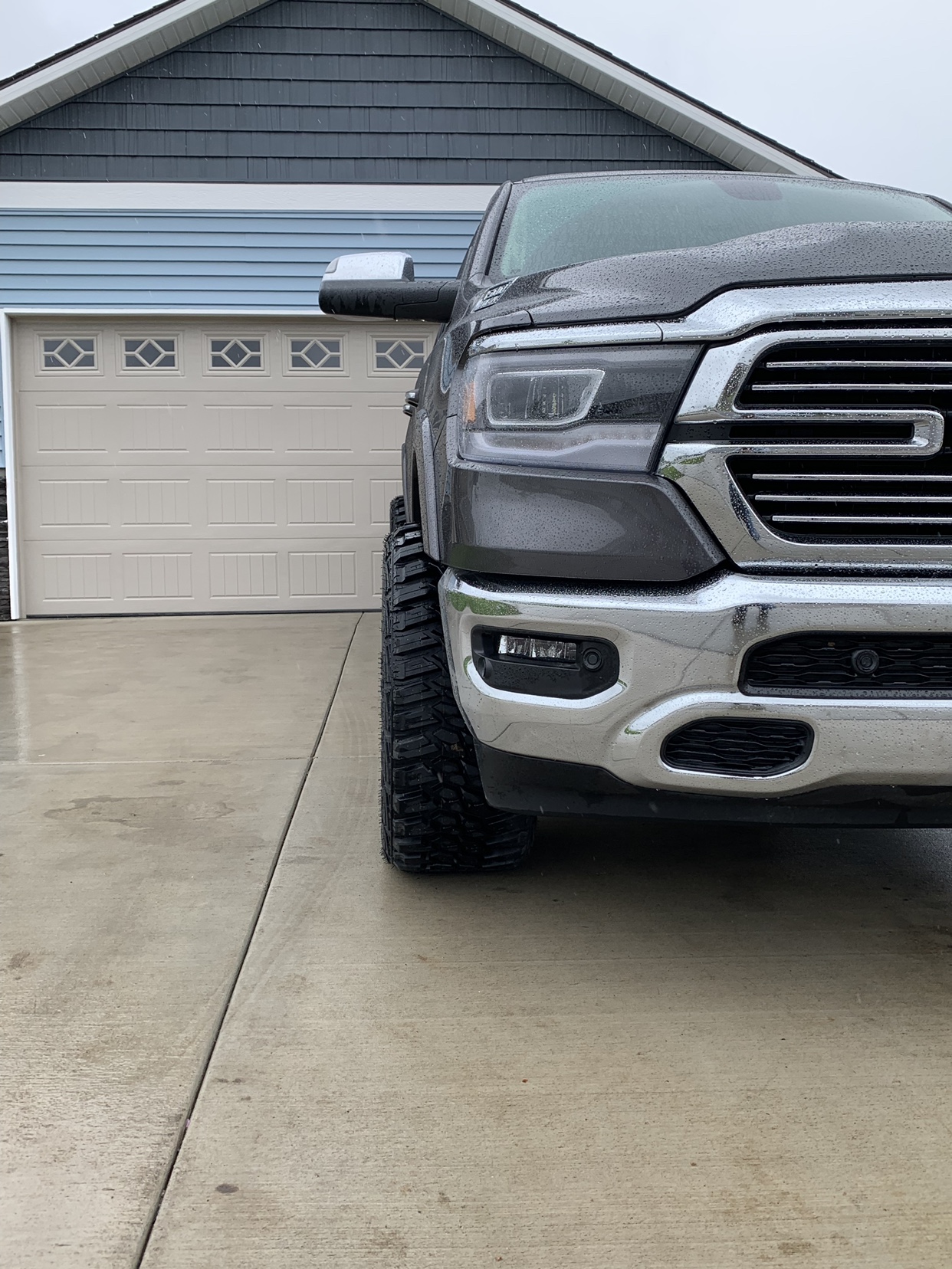

Haha, I’ll show more here shortly. I got it aligned this morning and that helped with some of the rubbing. It’s actually not bad. It’s minor rubbing on inner plastics. Gonna heat it up and mold it back a little and see if I can eliminate most of it without any cutting. Rest assured, pics are coming. It’s pouring down rain here right now, so I haven’t been outside much. Here’s a pic from my friends window, kind of shows off the offset. I’m still surprised at how less aggressive 12 wides are on the 5th gens compared to 4th gens.
Yes sir. Had to heat up some of the plastic on the passenger side and mold it inward a little, remove the plastic splash guards, and trim some plastic on the left side. Now it’s all good and drives great with no rubs.
