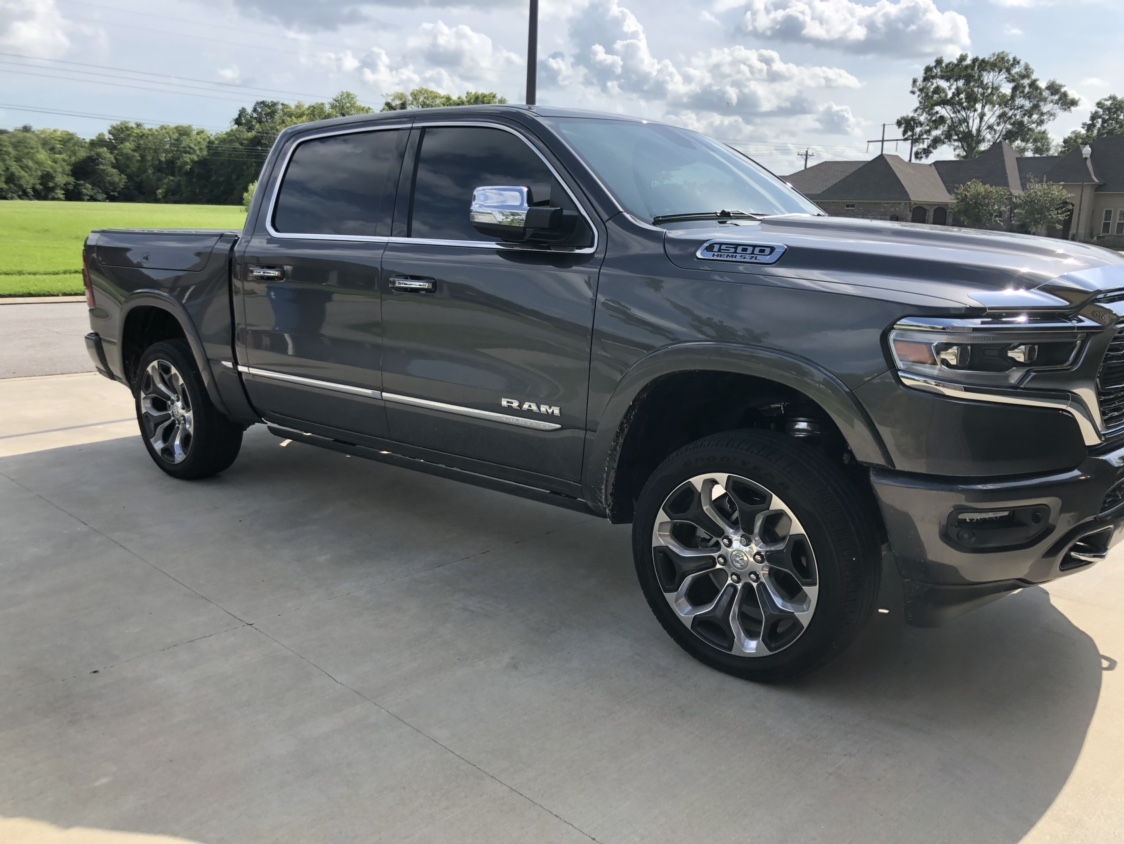

285/55R22 Nitto Ridge grapplers installed, i have the daystar spacers just waiting on the links to arrive to have them installed, as of now only have rubbing on full lock in normal mode, hopefully the leveling kit will fix that
Looks fabulous and I’m doing this exact set up!
my dilemma will be my beloved 2 inch wheel spacers. Do you think I’ll be ok or should I take them off?

I’m not sure about the spacers but with my setup above and daystar level kit on the front with revel links I have no rub in normal at all
Yeah I’m debating weather I should remove the spacers or do a little wet towel heat gun shaping
