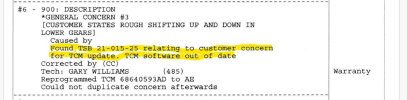

Took my truck back to my dealer for long list of defects.
One of them was rough shifting. They said that there is TSB / software update.
TSB info:

Yes on the 3.92. Took truck in and they performed a transmission flash this time. Takeoff is diffinitely better and so was hwy gas mileage. I have friends that have the HO motor and lower gears. He told me his truck was smooth as silk. Has to be the 3.92 rear end. Get the transmission flash. It's not perfect but 90% better
