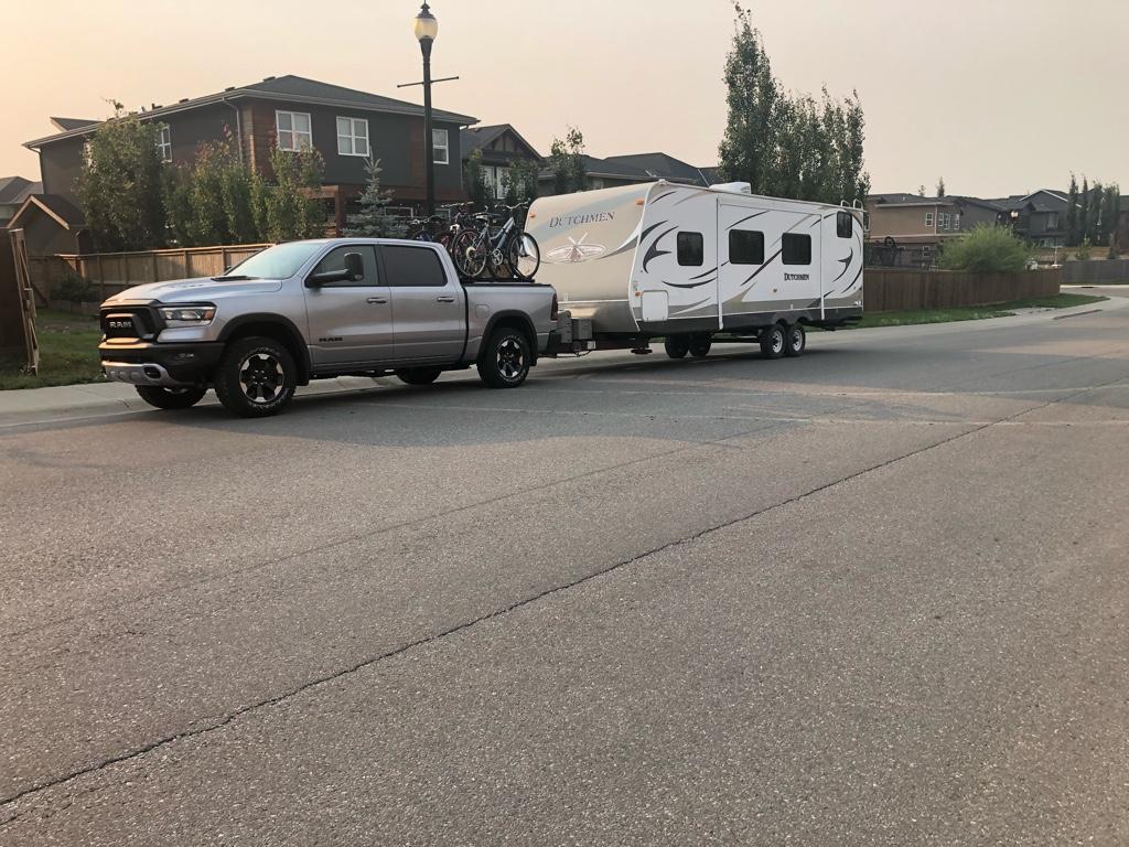

Here’s my 21 rebel ED, 33’ ball to bumper 7600lb loaded Dutchmen (scaled) ready to go. The only thing other than 4 passengers we have in the truck are the 4 bikes on the rack over the tonneau, bed is empty. Payload 1444lbs. Still had 200lbs left to GVWR on the scale ticket. Has Airlift 1000HD bags in the rear coils. Tows like a champ and still got mileage better than my old Hemi ever got unloaded on the highway.
Good Morning! I know I'm replying to an old post but I'm new to the forum and getting into the RV towing business, I hope. Do you happen to know what Transmission temps you run when towing this setup? Do you have anything in addition to the factory Transmission cooler?
