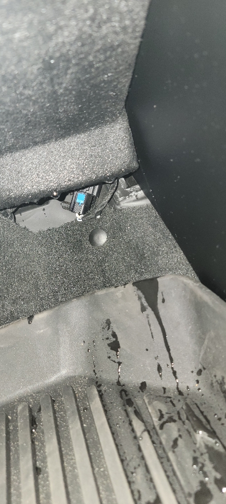

Well after some on an off rain I pull the mat and there is wetness again. Just the front passenger none in the back this time. Pull up the carpet and found the padding and the foam at the upper part soaked. Water is a little soapy so I'm thinking it's coming from outside

Got an appointment scheduled at the dealer. Been raining past two days and today I saw the water clearly dripping from underneath the glove box near the door. Not a small leak

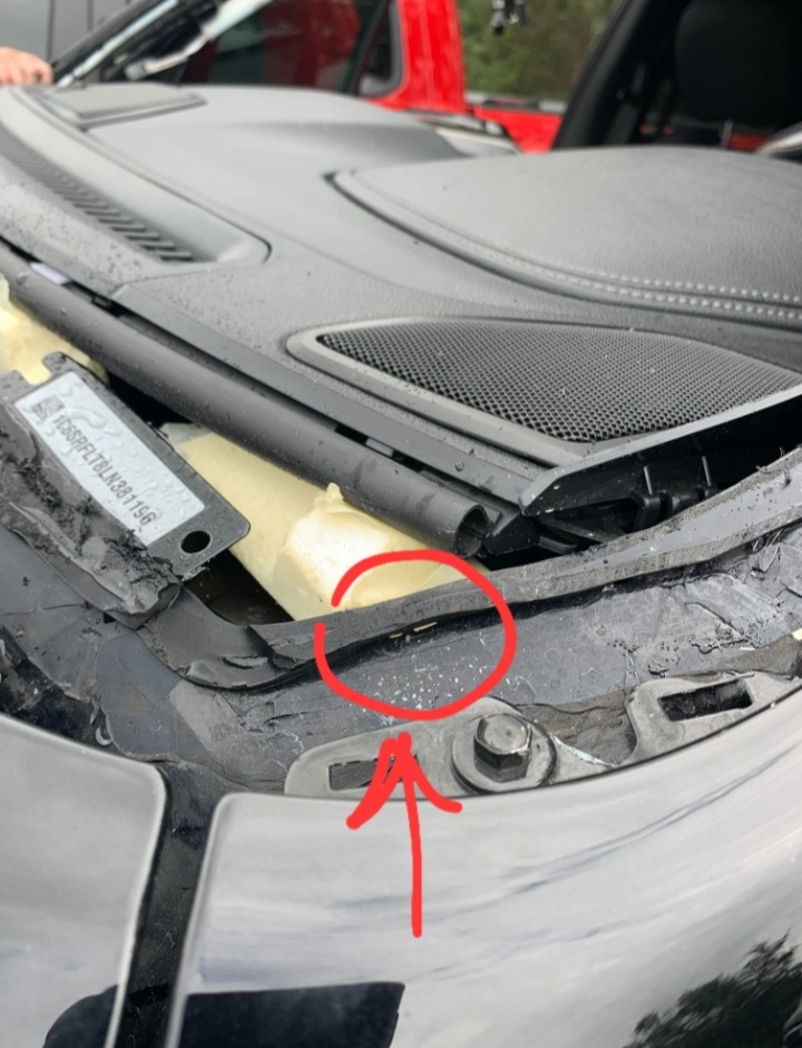

So just got a call from the dealer. They are saying that the leak was from the bottom of the windshield from a small area where the gasket was not installed properly. My windshield was replaced through my insurance by safelite last year. The dealer repaired the windshield but refuses to do anything about the mildewed carper and padding because the leak was caused by safelite apparently. I still do not understand how water would leak from the bottom of the windshield while the truck is standing still in the rain but I can pick up the truck this afternoon and hopefully no more leaks. On the brake moan they are claiming they could not reproduce. Which is pretty ridiculous. I literally hear the moan EVERY morning. It's like a fog horn. I had mentioned the TSB on brake moan and they say they cannot perform the TSB under warranty because there is only a 12k miles coverage of brake pads and rotors. My understanding is the TSB does not require replacement of pads OR rotors. Overall if the leak is fixed I am happy about that but I'm disappointed that my carpet may now be ruined and I have to live with this ridiculous brake moan every morning.

Here's some pics the glass tech at the dealer took of the issue. When safelite replaced my windshield back in august, the tech applied the urethane adhesive improperly. Most likely applied the bead to the glass instead of the window seat which caused a large gap on the passenger side and what looks like a small gap on the driver side. Next I'll be trying to get in touch with safelite to see about replacing the water damaged carpet, padding and whatever else. Lesson learned if your getting your glass replaced might want to keep an eye on the tech.

I've found wetness under the driver side all weather floor mat a few times myself. Like you , I hear the brake moan sometimes in the morning as well but no other time after that. Sounds like my Rebel is headed for some service too. 🙄
