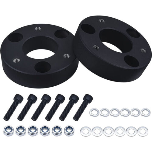

Ok, I'm back and a little less wet behind the ears 😂
Read through some more threads and now I'm thinking of just adding spacers and level links to level the truck and probably a size or two bigger tires. Like 285s or 305s
I think I'm gonna build my own level links and experiment with different heights. Have found a couple threads showing what ball fittings to order, threaded rod, etc.
Also found 2.5" spacers on ebay for around $40. From what I understand, even if they say, "not for air suspension" they will still work fine as long as you replace the links at the same time to prevent errors or over/under inflation
For example, these spacers. Will they be ok?
I could do all this for around $100 and 2 or 3 hours it looks like. Still need to learn more about disconnecting and reconnecting the air shocks, and if I need any type of extension on the air hose 🤔
Any suggestions appreciated

I read BORA spacers are a good option. I do not use them but that's what I would go with after research.

Yeah, they look good. It just seems like such a basic part the $50 ones would do the same as the $100 ones. But I know little to nothing about it so far
Also wanted to ask in the OP about UCAs. Are they needed? I've read mixed info on this

If you are not going to off road and you can get a good alignment then you don't have to have uca's. If you are going to off road you will need the travel for articulation. So you'll need aftermarket uca's.

Thank you for the info. I do very little off-road....but. when you need it, you need it! I suppose
Could you elaborate on what exactly would or wouldn't happen in an off-road situation with stock arms? Do they limit the travel, I assume?
Limit extension or compression?

Well for starts, when you lift/level and add bigger tires they may rub.
Then anything 2" or more, your changing the geometry of the truck and the way the suspension "sits". The UCAs will compensate for the lift/level and bigger tires so it "maintains the geometry and Keeps your upper ball joint in proper alignment with the new bigger tire. Just do it. You’ll only regret it if you don’t. Not only that the UCAs are fairly cheapy from factory.

Yes. They limit drop. This puts stress on the components since they cannot travel the full distance they need to because of the preload on coilover, or the additional length of the strut due to the spacer if that is used.
