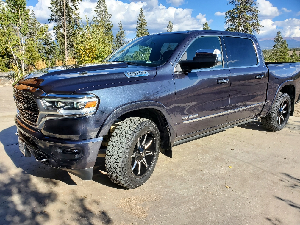

I have the same setup in stock suspension

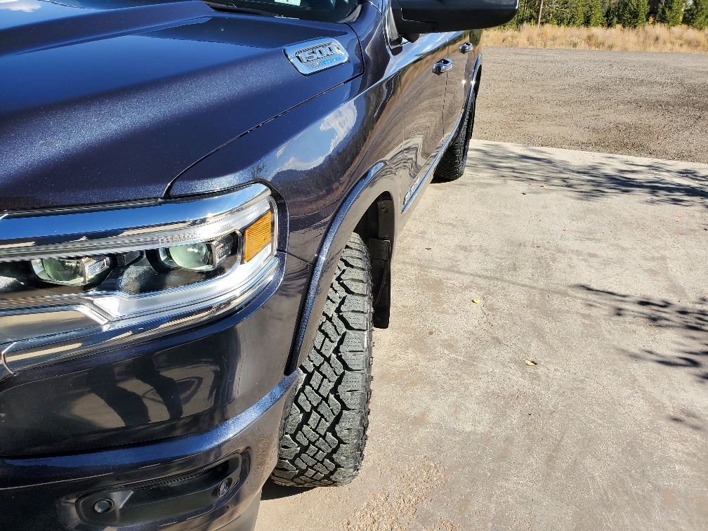

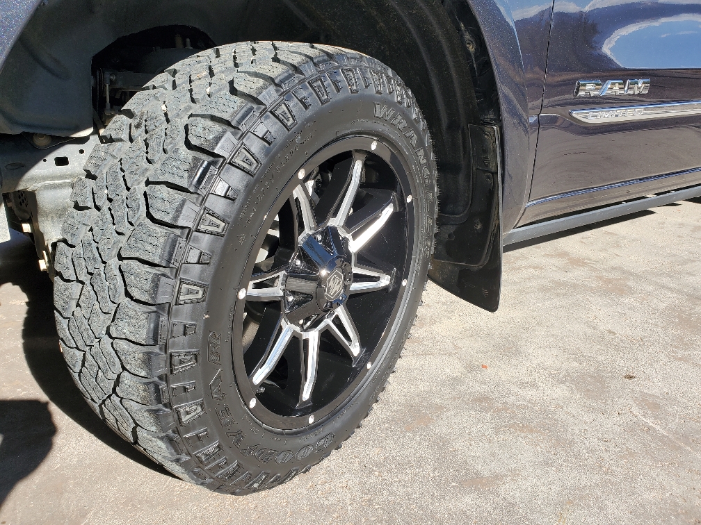

I changed the 22" OEM wheels to 20" Mayhem Rampage wheels with -19 offset. My tires are a little narrower than yours - 275/55R20 (snow!!). They are flush with no poke and the WT mud guards present no clearance issues.
Sorry offset is 18mm not 19.....
You are correct, offset is +18 not -18. I was going from memory, something I should know not to do at my age....
...and to be more accurate in your description, +18's are not flush with the fenders. They actually sit ~3/4" inside the fenders.
