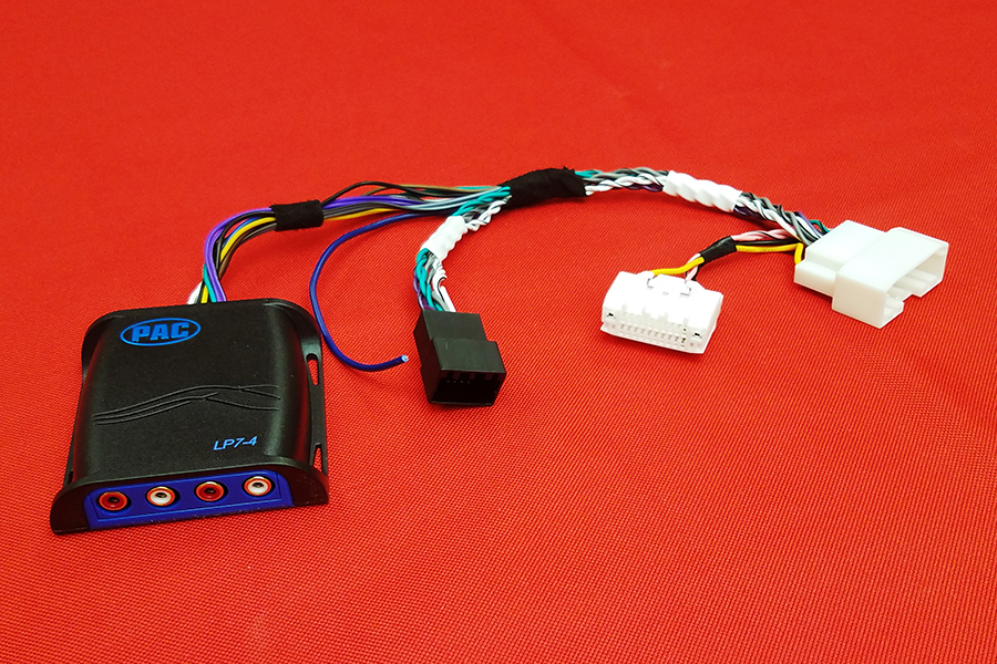

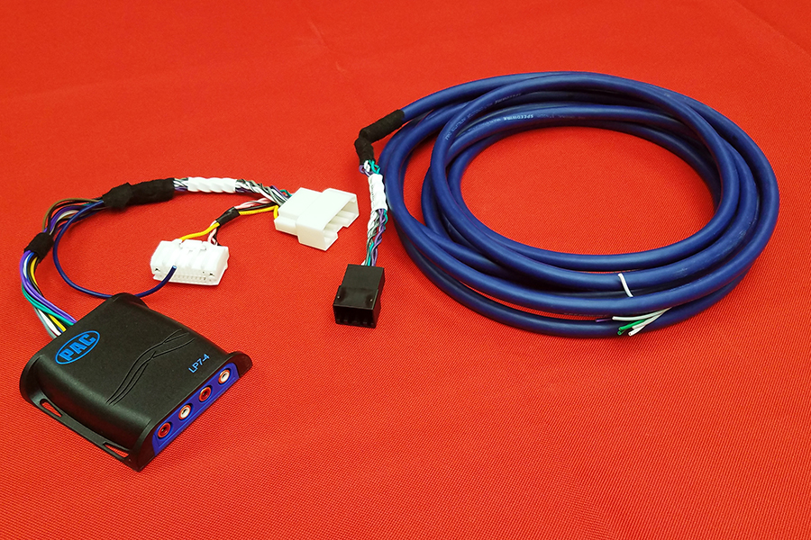

Wonder how this is so simple and the other option is that expensive and more complicated pac amp pro.
I just need one channel to add a sub and leave the rest alone. I've done the whole rewire the entire vehicle thing and I am kinda over it. I trade vehicles too often.
Edit: NM, I see now. That harness is a high level output. The AmpPro is not and combines all channels for a full range output instead of limited by the stock preset frequencies.

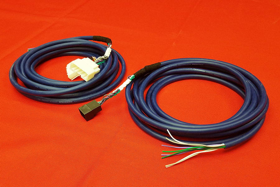

That harness is unnecessary. Just buy the PAC harness and wire to a hi/lo converter. 17’ wire will allow you to put the amp by the tailgate.

I think with anything but the pac amp pro you're stuck with whatever the factory speaker wire frequencies put out. It might be worth the extra cost for a clean flat signal.

What is this one for?
This gives you just an rca output that you can use for a subwoofer amplifier without messing with your speaker wire harness. If you plan on putting an amplifier in for your speakers you can use the harness you put a link to. If you have the Alpine system you need a different harness that they provide on their website

Sorry for all stupid questions, I am thinking of putting an AMP in. It looks like this harness would be good for that, but I still don´t understand how I don´t have to mess with speaker wires...?
Is that the black connector?
If so, where does it go?

Amp for what? Just a Subwoofer? Mid/Highs? Or a 5 channel amp for all? You disconnect the wires that go into the module under the driver seat and plug this in to the corresponding plugs and you will have the speakers through the ram module but you will get a rca output that you will run a wire from the Net module to your amp. The small blue wire is a trigger wire that will turn the amp on. I will try attaching pics from my set up.
