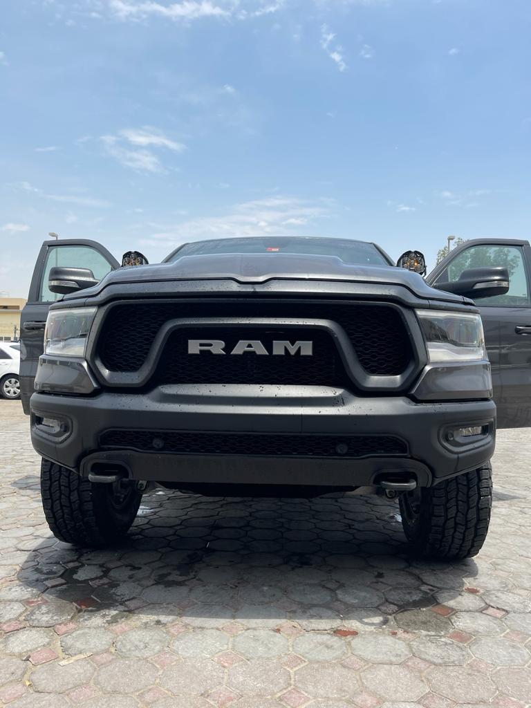

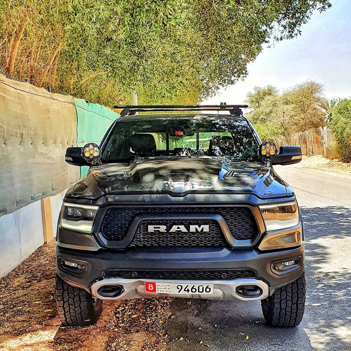

Hi'yall,

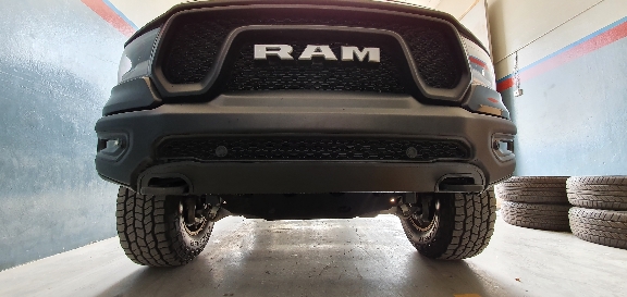

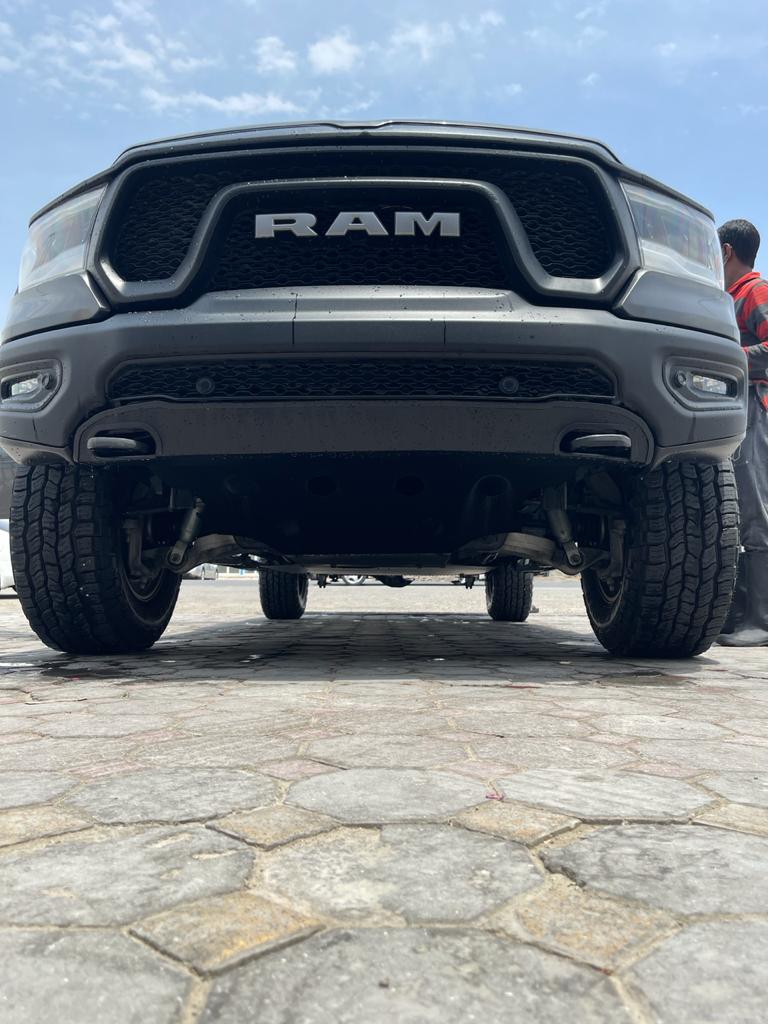

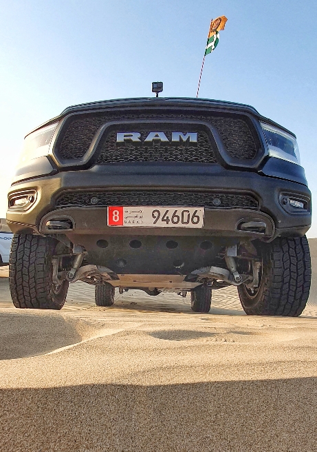

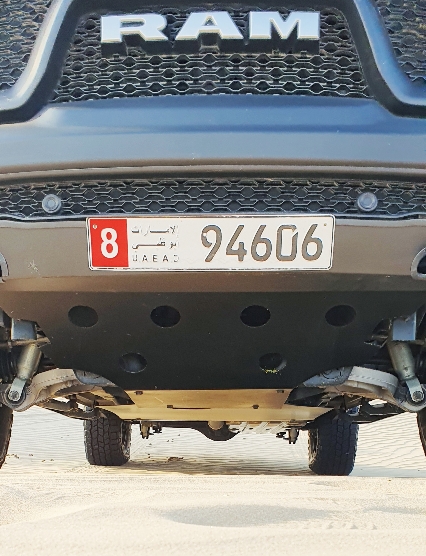

So after much research on aftermarket parts I went and got a custom bash plate and skid plates fitted to my 2019 Ram Rebel. All made from mild steel:
Front bash plate 8mm
Skid plates underneath 6mm
This setup keeps the stock bumper with all parking sensors, fog lights and air grills.
The trucks has the following suspension/tire mods:
Bilstein 6112 up front (notch 7).
TOTAL FAB UCAs
34 inch tires (Cooper AT3 XLT3) 295 / 70R / 18
Total lift is 2 3/4 inches.
Am going to put the 6112's on notch 8 now as I feel the front of the truck has dropped slightly due to the extra weight.
Enjoy the pictures.

Was $600 in total. That includes bash plate up front and skid plates underneath...almost as far back as where you sit as a driver.
