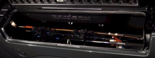

2019 Rambox Gun mount??
Ram1500Bear
Apr 13, 2020
I have a 2019 Ram 1500 Crew Cab with rambox and looking to get some sort of mounting system in the rambox. Any ideas?

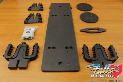

Ram also sells a kit which I think may have gun mounts (long gun). You can find them on ebay.
Check this out......
Ram1500Bear
Apr 13, 2020
Unfortunately its only for the older body style of a 2019
