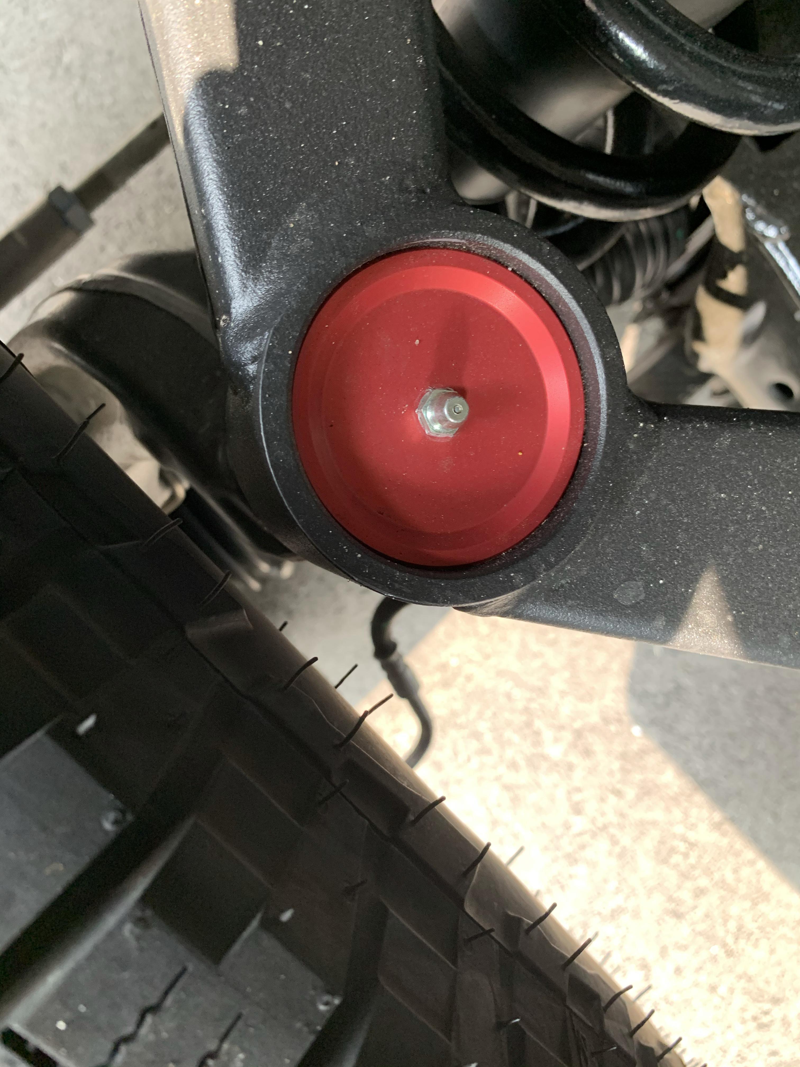

Here is what the stock rims, stock Falken WP AT2Wa’s and Zone UCA’s (same as the ones the leveling kit your looking at) look like. It’s close!

Wow that is close to the UCA!!! And those are 275!!!
I don’t think 285’s or 295’s would work.

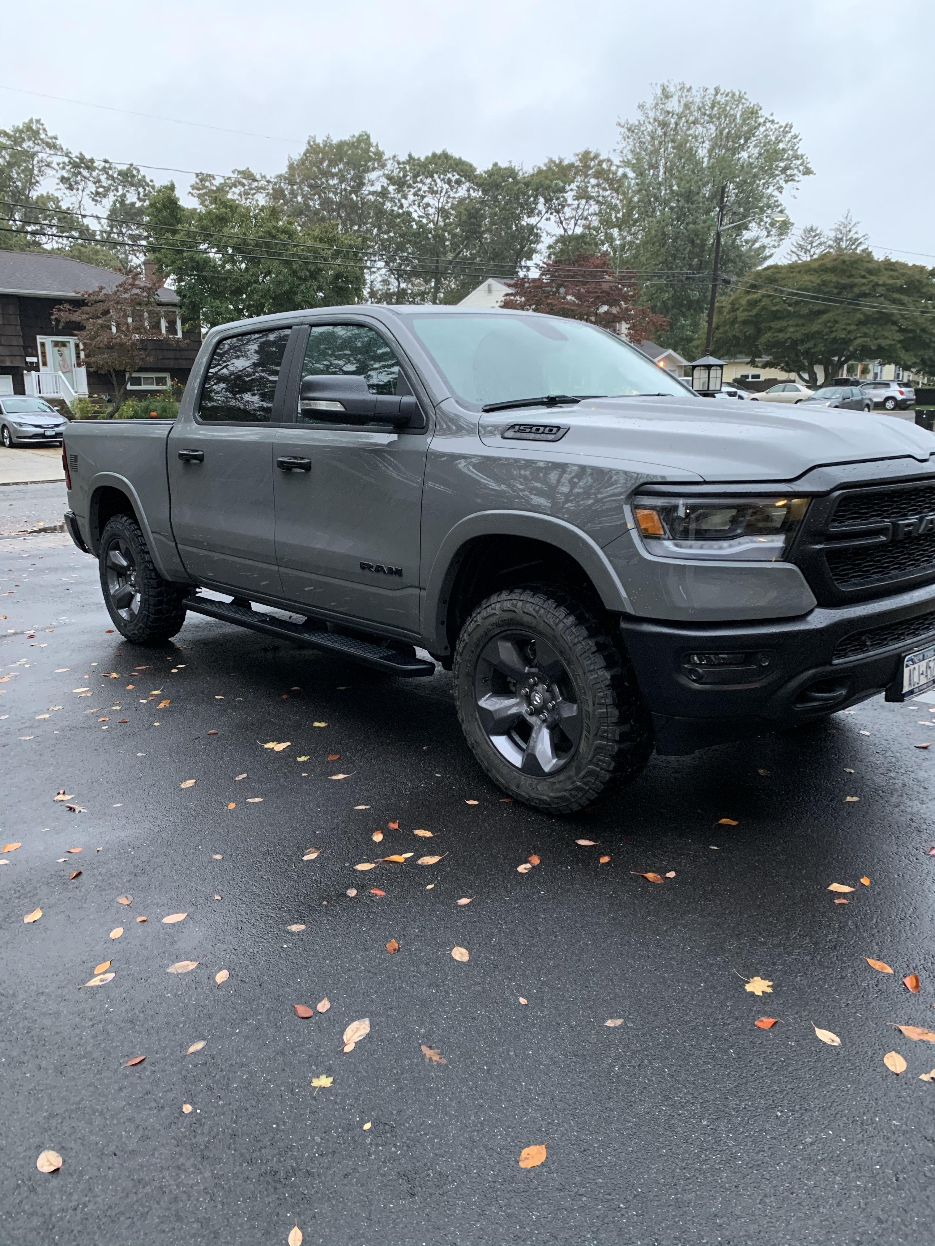

Here’s the 275/65’s w/ Eibachs set to 1.8” w the ORP

You can definitely go with 275/65R20 on stock wheels. Basically 34/11.

I just checked my truck and yeah there is like maybe 3/4 inch gap to the UCA. 285’s gives me less than 3/16th gap if I did the math right. It will clear but that’s a bit to tight for my preference!

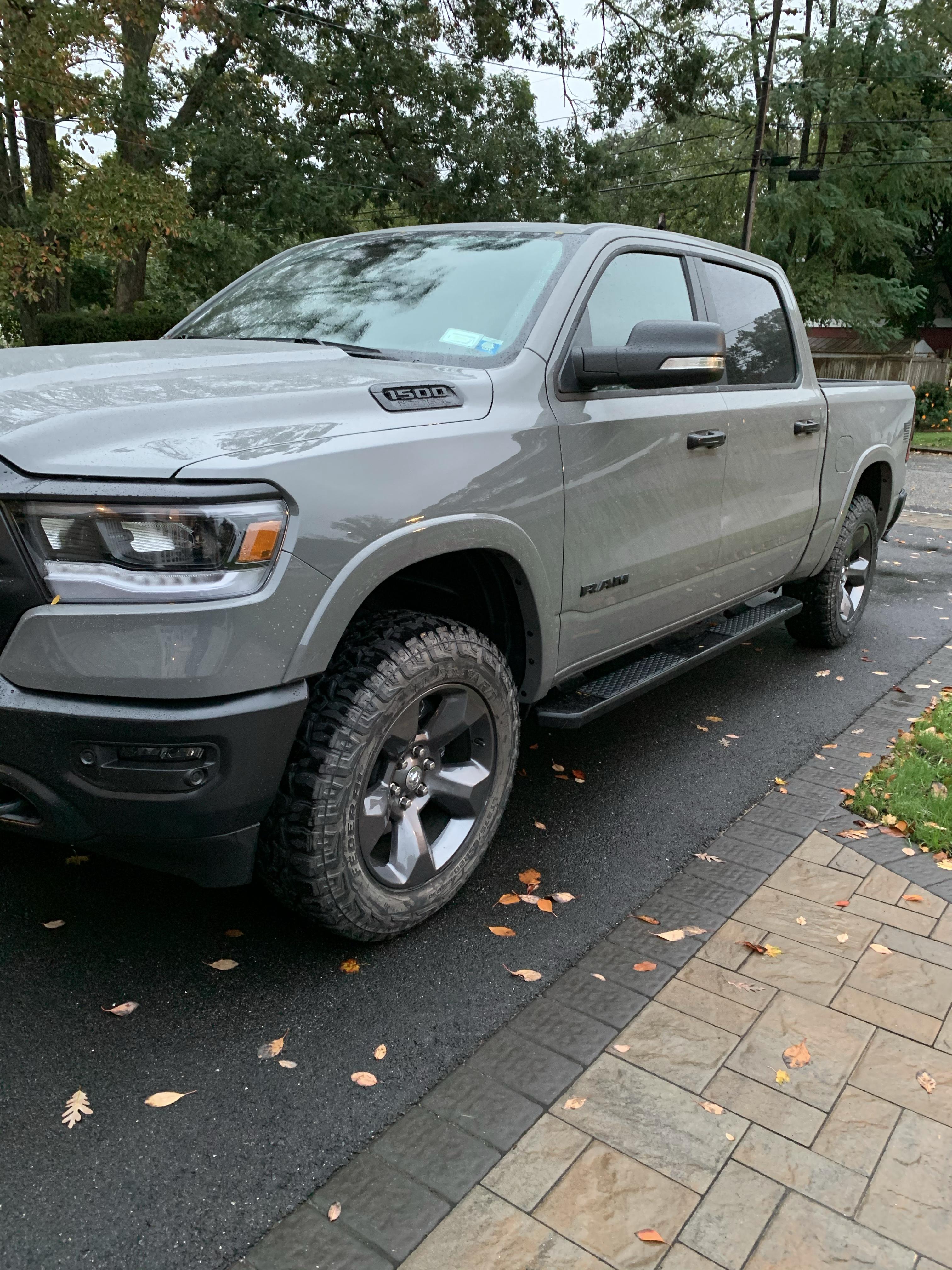

Way late I know, but may help anyone still wondering. This is a 2wd 2019 laramie sport. Has 1 1/2" hub centric wheel spaces with 275/65R20 (34"x11") recon grapplers (4ply, i dont need 10ply) Bilstein level shocks at 2" height. No rub at all. Great tires too.
Awesome, thanks for sharing! I think this exactly what I'll be going with on 2019 Laramie 4x4. I already have 1.5" wheel spacers, and I'm currently shopping for a 2" lift strut kit. I have the offroad package, so I'll do the upper control arms too. Sounds like 275/65R20 is the way to go!
