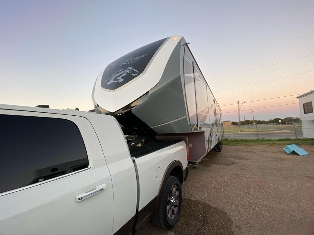

I have 37000 miles on a one ton Megacab and haul huge 42ft 5th wheel and mine are fine.
