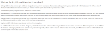

the web site is very busy because it is what is used to check for open roads.
this one might work better
these sites are what everyone uses to see if chains are needed
here is a screen grab
iirc there are different levels of restrictions. I think R2 is all but 4x4 vehicles need chains. R3 is everyone need chains. I could be wrong on the numbers but I am certain there are tiered requirements and they announce it according to the road condition and weather forecast.
I know this because we used to do snow runs a lot and even toyed with the idea of charging "tourists" (aka those city people who can't drive in wet) to tow them out if they get stuck lol
