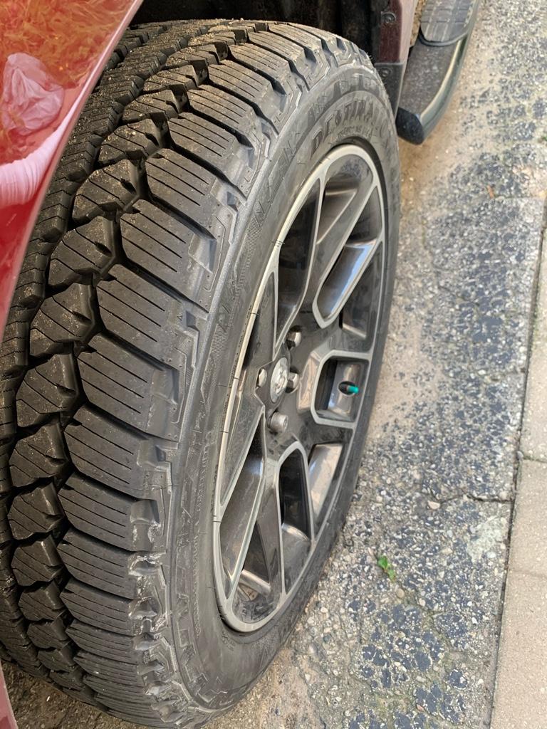

All I did was swap stock tires with something more aggressive looking - and much better handling and more practical

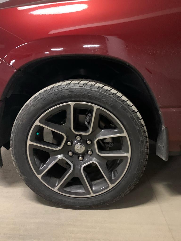

Long story short, I am limited to using one arm at the moment. I am getting 79" but I can't measure directly to the sharkfin because of that brace between the bed and cab. I did measure my ceiling in the garage then the ceiling to the sharkfin to obtain 79" height. Does this sound right? Hard to believe this truck is taller than my 2016 after it was leveled with larger tires. And these tires are smaller than 2016 stock!

Unable to see any designation in your picture other than "Firestone."
Model? Size?
EDIT: found your info posted elsewhere.
Firestone Destination AT2 285/45/22
